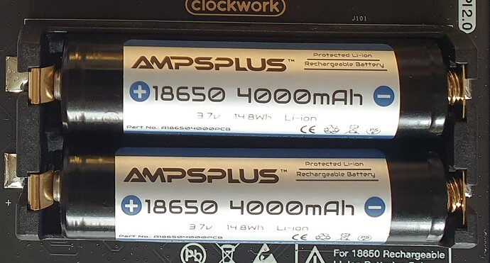

Mine is much better than that. Maybe your batteries are self-discharging somewhat more than most ?.
18650 cells drop off fairly quickly from the 4.2v down to 3.7v and level off for most of their cycle and then drop off down again, think of the 4.2v more like a surface charge, 3.7 is their real working voltage. a bit like NiMH cells, they will charge to 1.5v but most of that is surface charge, their real operating voltage is about 1.2v.
Also the protection circuits will draw power as well as the Picocalcs standby current for the Power switch monitoring (is so negligable though).
hope that helps a little :smiley:
