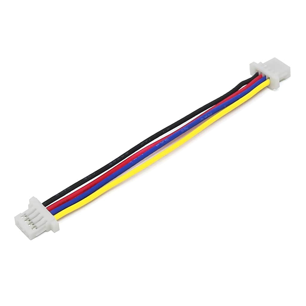

Having trouble finding i2C cables (Stemma/Qwiic/QT) shorter than say 5cm. Also no luck finding a crimp tool kit to make my own, also screened/twisted pair i2C cables. Located in or shipping to UK needed.….
I am hoping you mean Qwiic/STEMMA QT cables?
Yes, post updated and meant to say shorter than 5cm….
