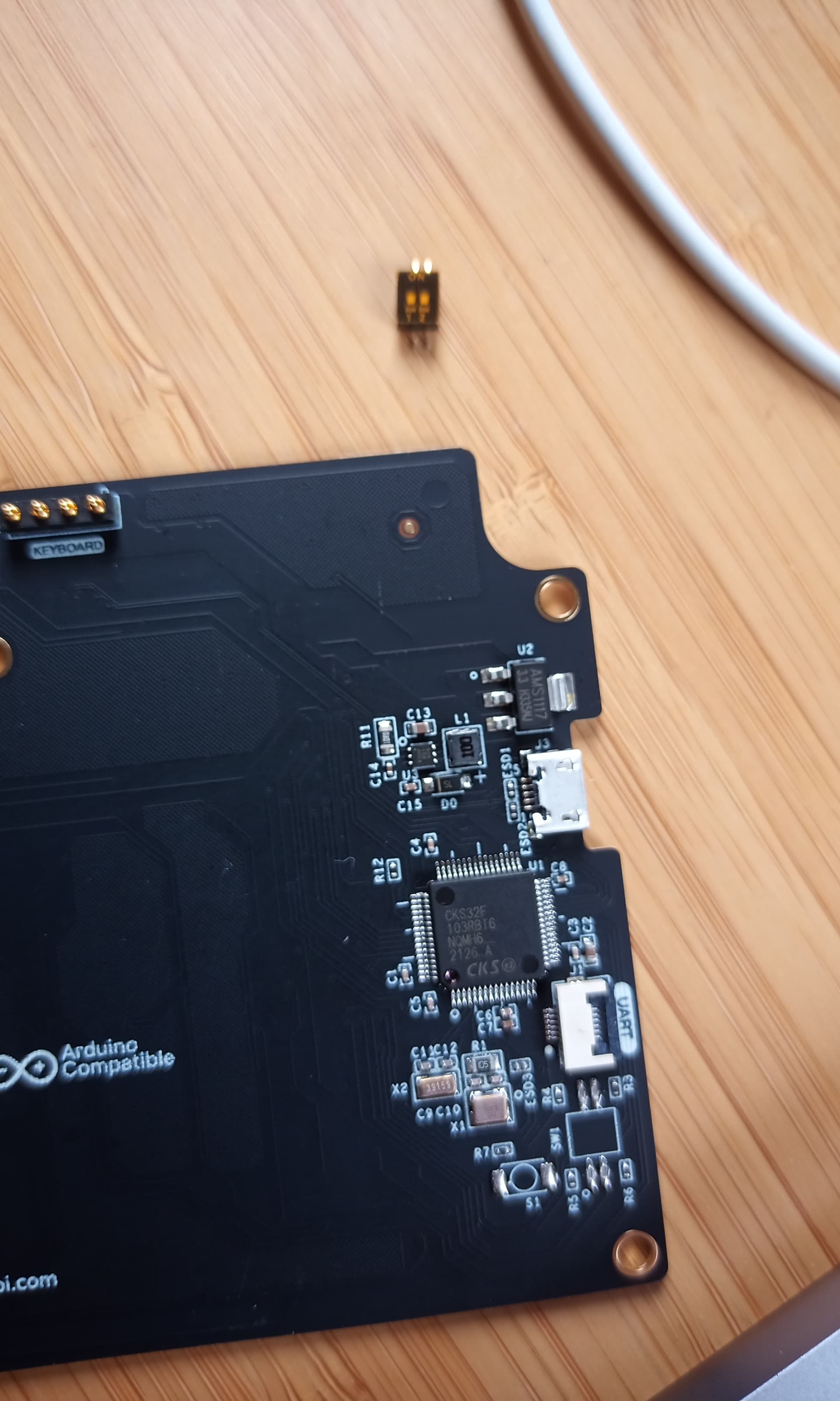

the switch on the back of my keyboard has came off:
but since they are on the off position I would assume that shouldn’t affect default functionalities?
i couldn’t find the schematic diagram for the keyboard, anyone knows what do those switches do?
Update: tested, keyboard works fine without them attached…

One of them force the keyboard microcontroller to start in the bootloader mode, the other is used to switch the joystick buttons in joystick mode or keyboard mode
thanks mate, sounds like a good idea to solder it back on

You can also try to contact CPi to see if they can solve that issue for you, they probably would be able to send you a replacement.
But yeah you can try to solder it back yourself if you are not afraid to do so
