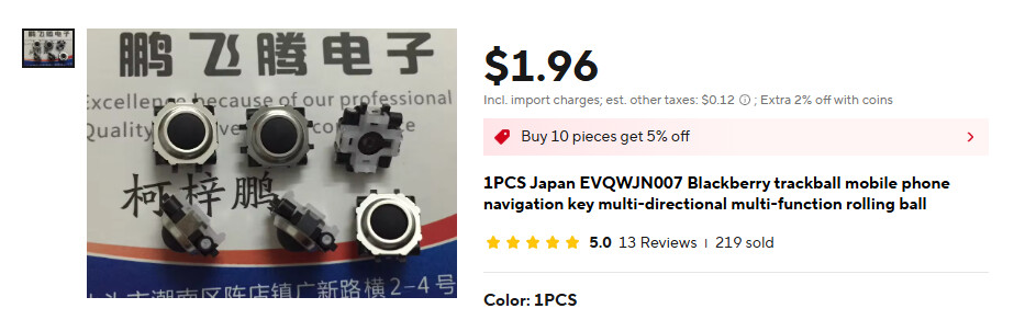

A lot of people replace the stock trackball with a trackball with this one. Model EVQWJN007
https://www.aliexpress.us/item/3256802802650565.html
I’ve replaced my 2 uConsoles and the DevTerm when I had one with them. 100% better then the stock one IMO.

Do you know of a current source? The link is dead.
the link changes all the time, also depending on location, just search aliexpress for the part number
Thanks, found it! Blackberry trackball!
you may need to order it from different sellers as they are not the same even if they have the same sku
If you have one, you could try the original link with a VPN. It still works for me, just set your location to a different country. That way you can be sure its the right part..
Which country? I have NordVPN
This is where the link points from England
