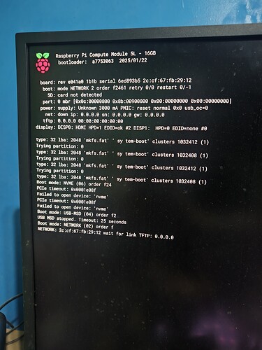

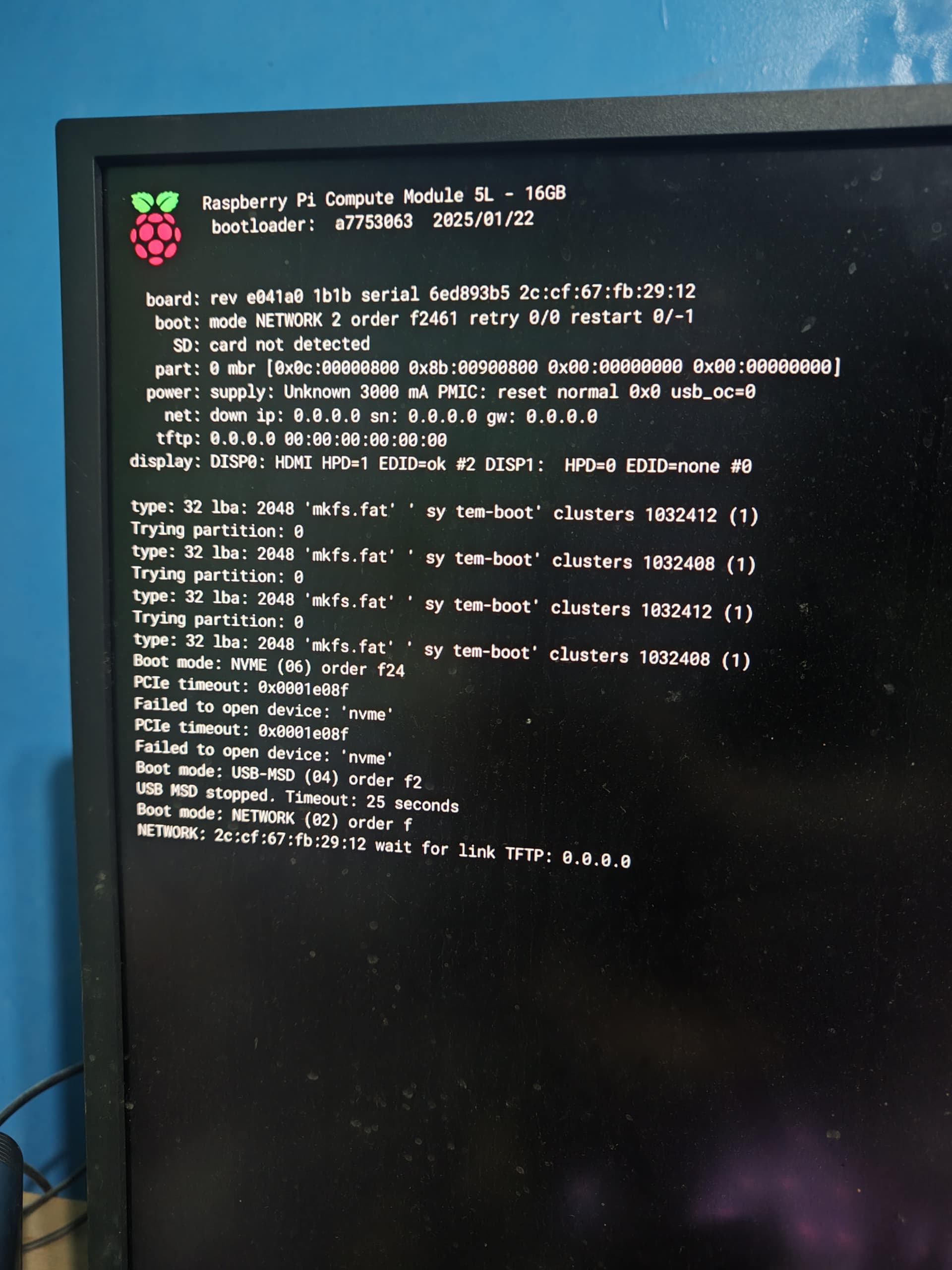

I’m getting the microSD as non-detected and a problem with mkfat during the boot…
You just need to find a sd that’ll work in the system as is so you can edit the eepeom. i have instructions in this thread and a sd card that is known to work.

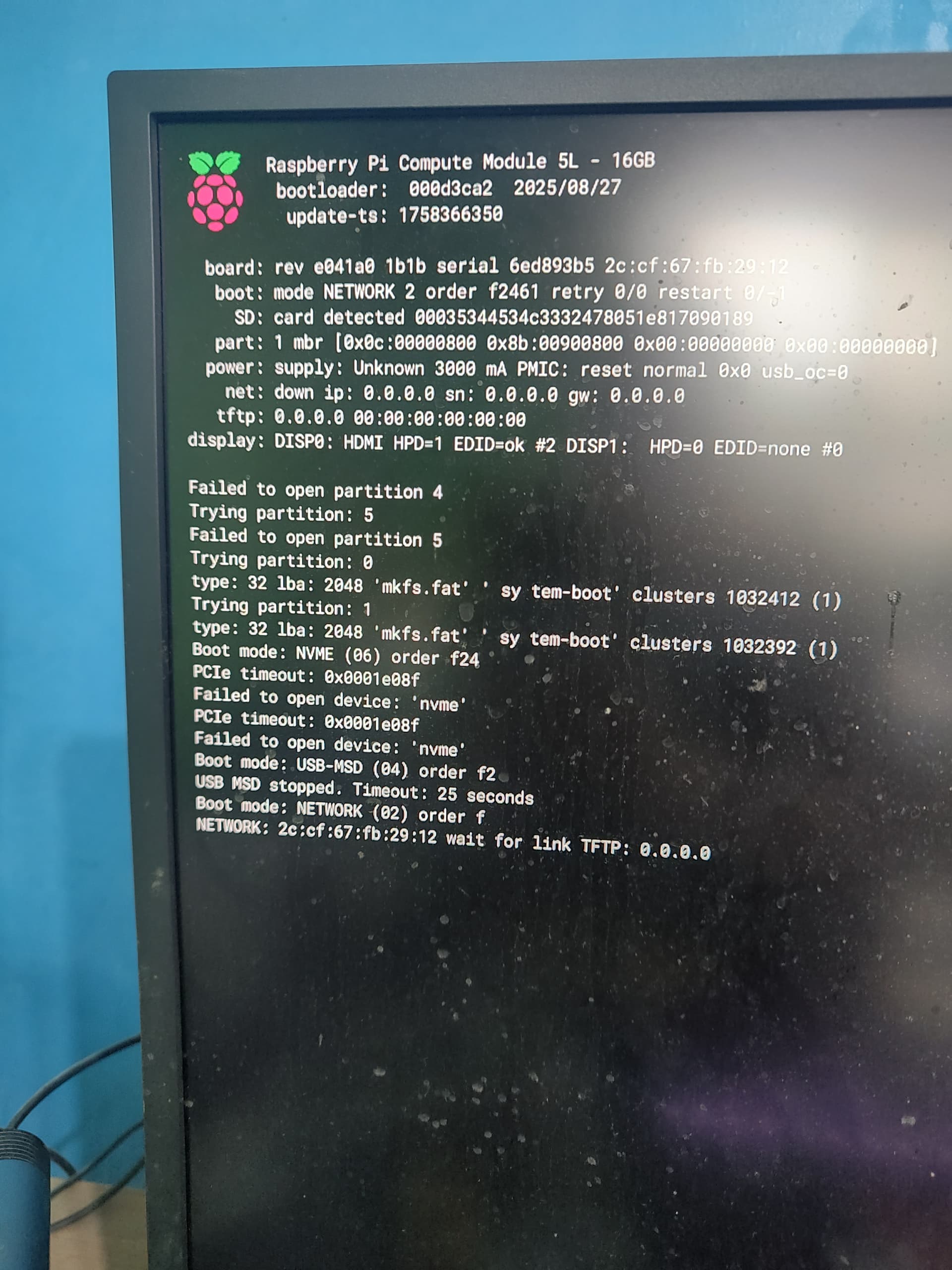

UPDATE 2: After the eeprom update I can see the bigger SD card appears as detected, which is good, but still doesn’t boot it.
I tried adding that config to existing config.txt file, and also replacing all the content by that configs. Didn’t work in both cases.
It says it can read the FAT partition (I can send a photo, if you want).

sure post a picture of the error.
A added at a first try and replaced the content by the config in your post: EEPROM config and the CM5 lite
You can see in the top the SD card appears as detected, which didn’t happen in my previous photo.

are you saying you put the contents of that post in your config.txt? if so that won’t work you need the cm5 booted to edit the eeprom as it lives in the bootloader of the cm5.
also i don’t think that sd was flashed right as there should only be 2 partitions on the sd and the screenshot says "failed to open partition 4 & 5. reflash the image without decompressing it using rpi-imager without any custom settings.
On Linux I could mount the boot partition and change the file. What I’m doing now is putting some /dev/zero in the SD card to clean up the partition table and then I will rewrite the image.
I need to decompress first, or on-th-fly, so the image be recognized, since .xz is the format that compresses the file. But if doesn’t work I will recompress and try using the RPi Imager.
there is no file to change on the sd card. the eeprom lives on the cm5, like a bios. so you need to have the cm5 booted to change the settings. there is nothing in the config.txt that you need to change to run the image with a uconsole. reflash the image do not change anything in the config.txt. you need to get into the os then follow the instructions in that eeprom post to make the cm5 work with other sd cards.
