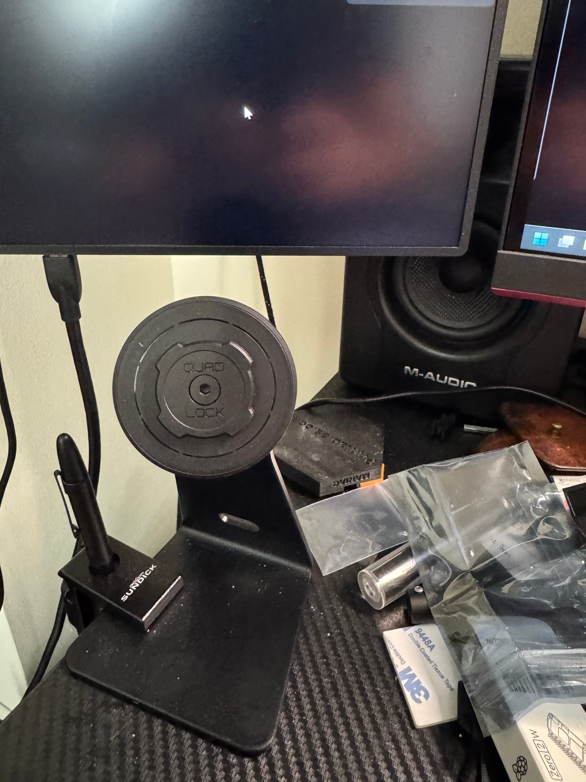

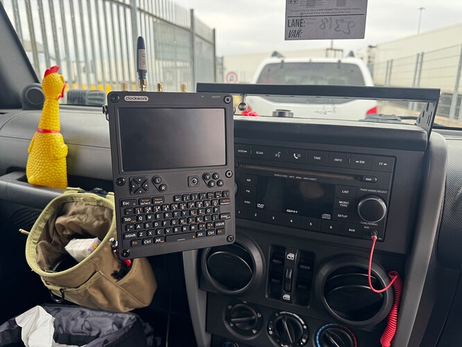

Here’s an option that I currently use at home but it should work in a 4x4 too; I might be testing it out a bit later in my Jeep Wrangler to see how it holds :sport_utility_vehicle:
So yes, back with an update it holds pretty well on a quadlock in a car
will be interesting to see what the heat does to the double stick tape.
