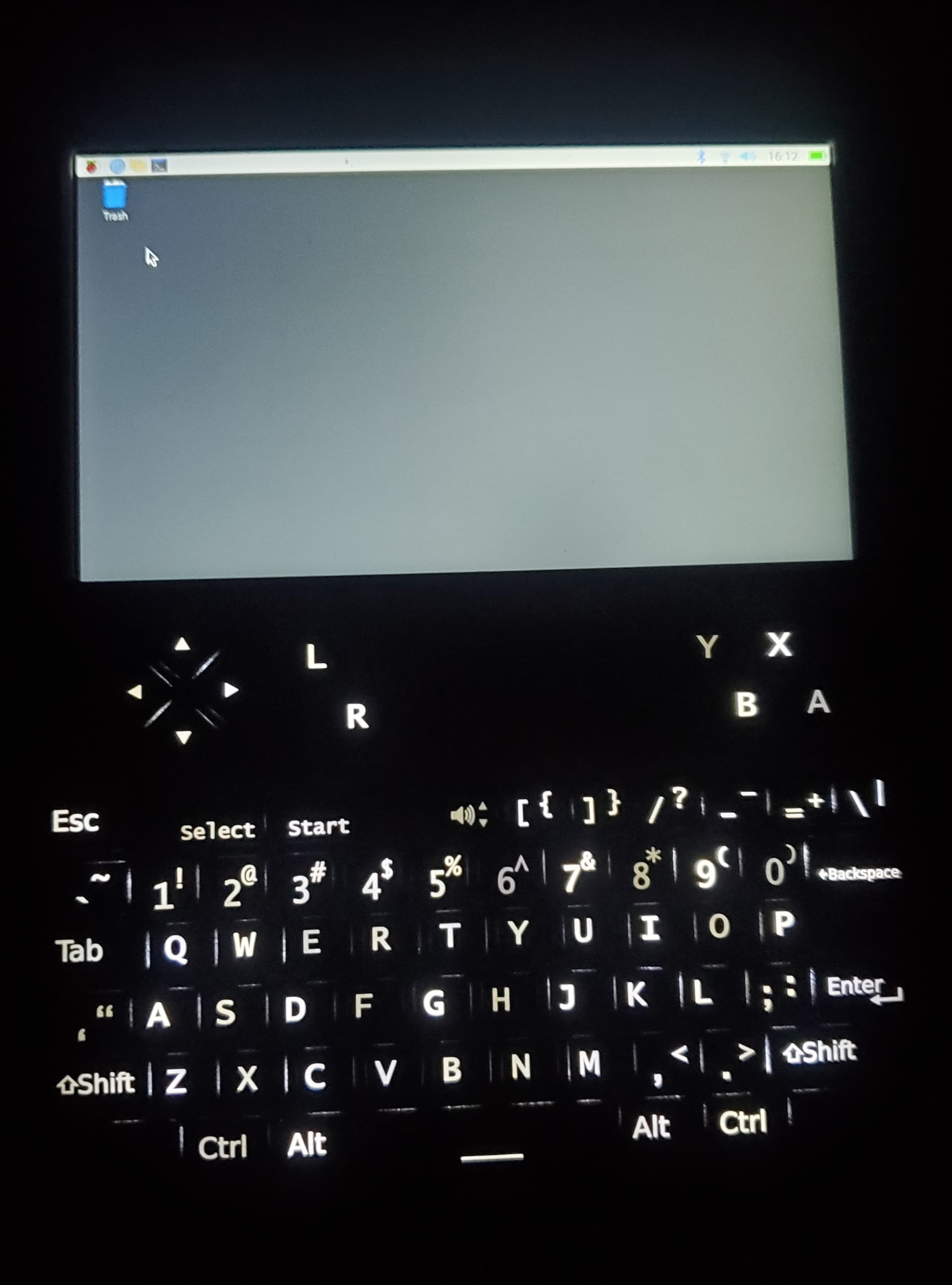

Does anyone know how well the uConsole’s keyboard backlight should light up the keyboard? To be frank, i get some keys like the a, w, g, j, 7, and 9 keys lit up ok, but the surrounding keys are very dimly lit (even on max brightness). is this normal? Or perhaps is my diffusion paper insert not aligned correctly?
that’s normal. my 7 and 9 are very bright compared to the rest. With the - = \ being the dimmest. all are a usable brightness though.

Brightness depends on whether that white plastic sheet between keyboard and rubber keypad is installed or not…
With that white plastic light diffuser: light is more even but very dim, almost unusable.
Without that white plastic light diffuser: light is uneven, but usable, text pretty readable in low light.
Wow, you weren’t kidding! I tried removing the light diffuser, and it was like night and day! What used to be very very difficult to read, now comes through very nicely. It might not be as even, but having extremely even dim light is kind of useless.
To be honest, I’m not sure how many people would prefer using the diffuser. It almost seems like it should have been called out as optional in the install guide, as the default of not having one seems like the much better choice.
