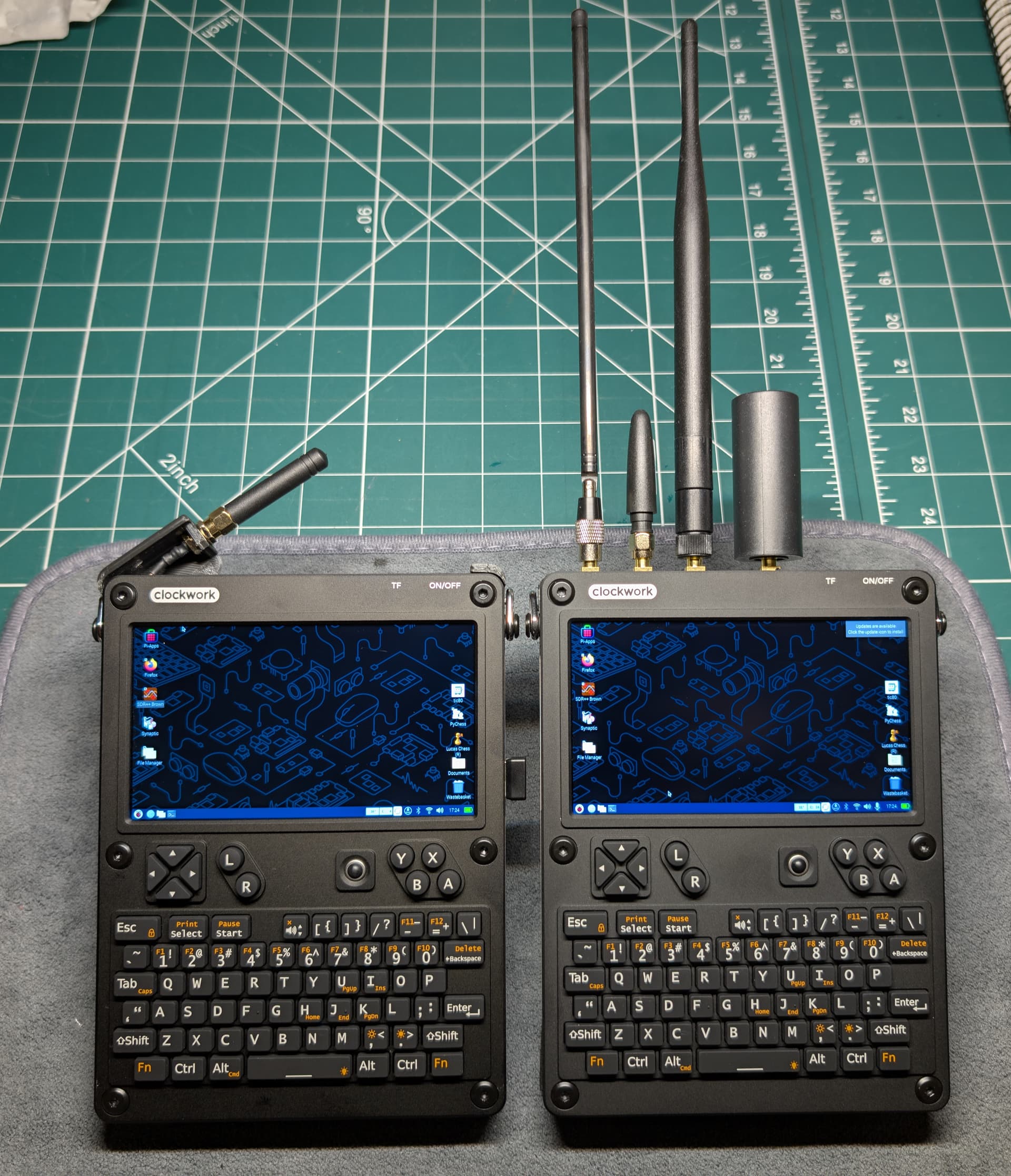

Just finished building the one on the left, which arrived this week. CM4 on the left, CM5 and HackerGadgets AIO board on the right.

The one on the left is supposed to be for Python/PICO-8 dev and learning Linux, but @white-round-square forced me to download RetroPie :face_with_hand_over_mouth::grin: and now I have a feeling it’s going to become an emulation device for the foreseeable future! :sweat_smile:
