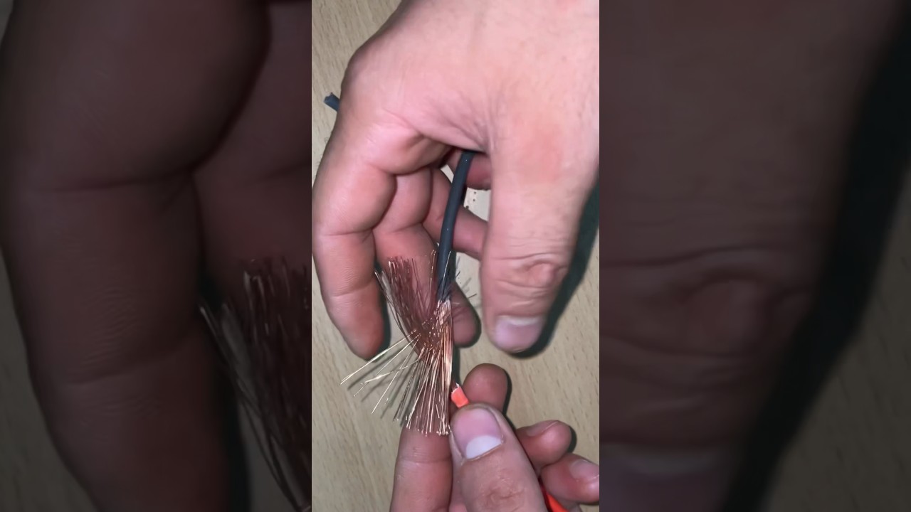

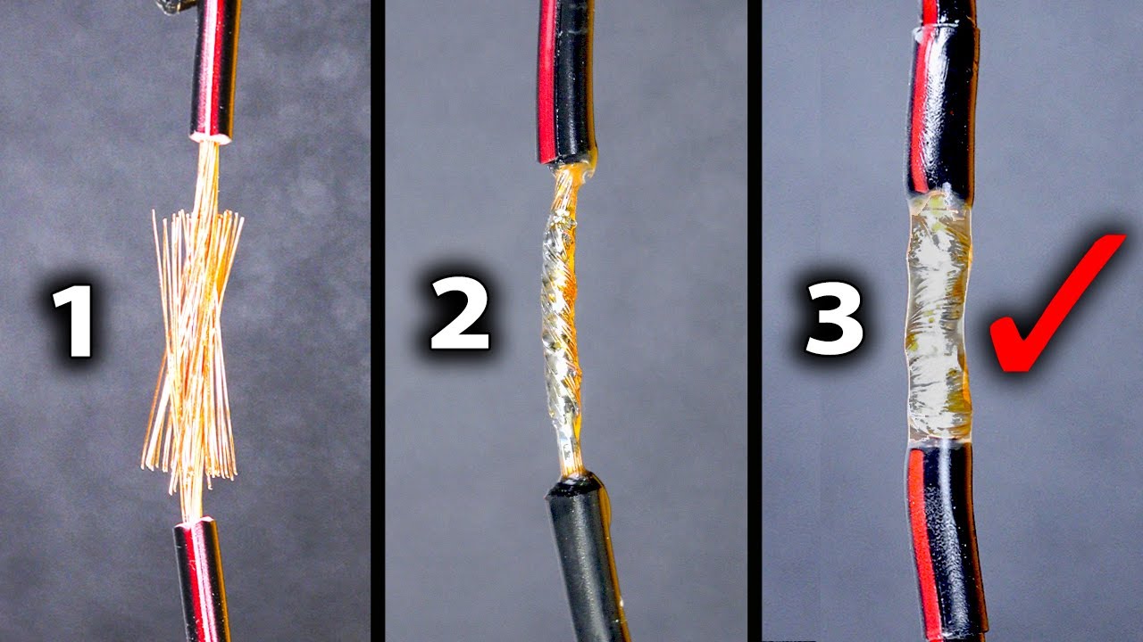

  1. Make a married connection, then solder it. Check this tutorial for how to do it:
Then for soldering, just apply a generous amount of flux on the metal wires, then solder it. Make a saturated solder.
  1. Secure the heat shrinking tube, make sure that it cover the entire exposed metal parts, then let it shrink with a lighter or heat gun.
Repeat the same process for the other wire.
