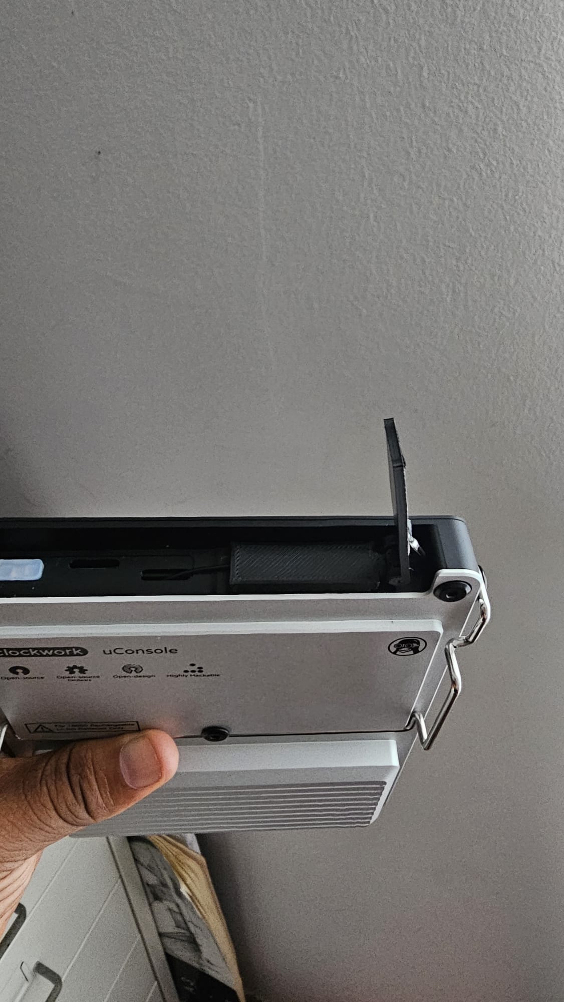

This is a foldable WiFi antenna adapter designed for the Clockwork uConsole.
The metal body of the uConsole tends to reduce WiFi performance when the antenna is too close to it.
This adapter creates extra height between the antenna and the device’s body, helping to improve reception and stability.

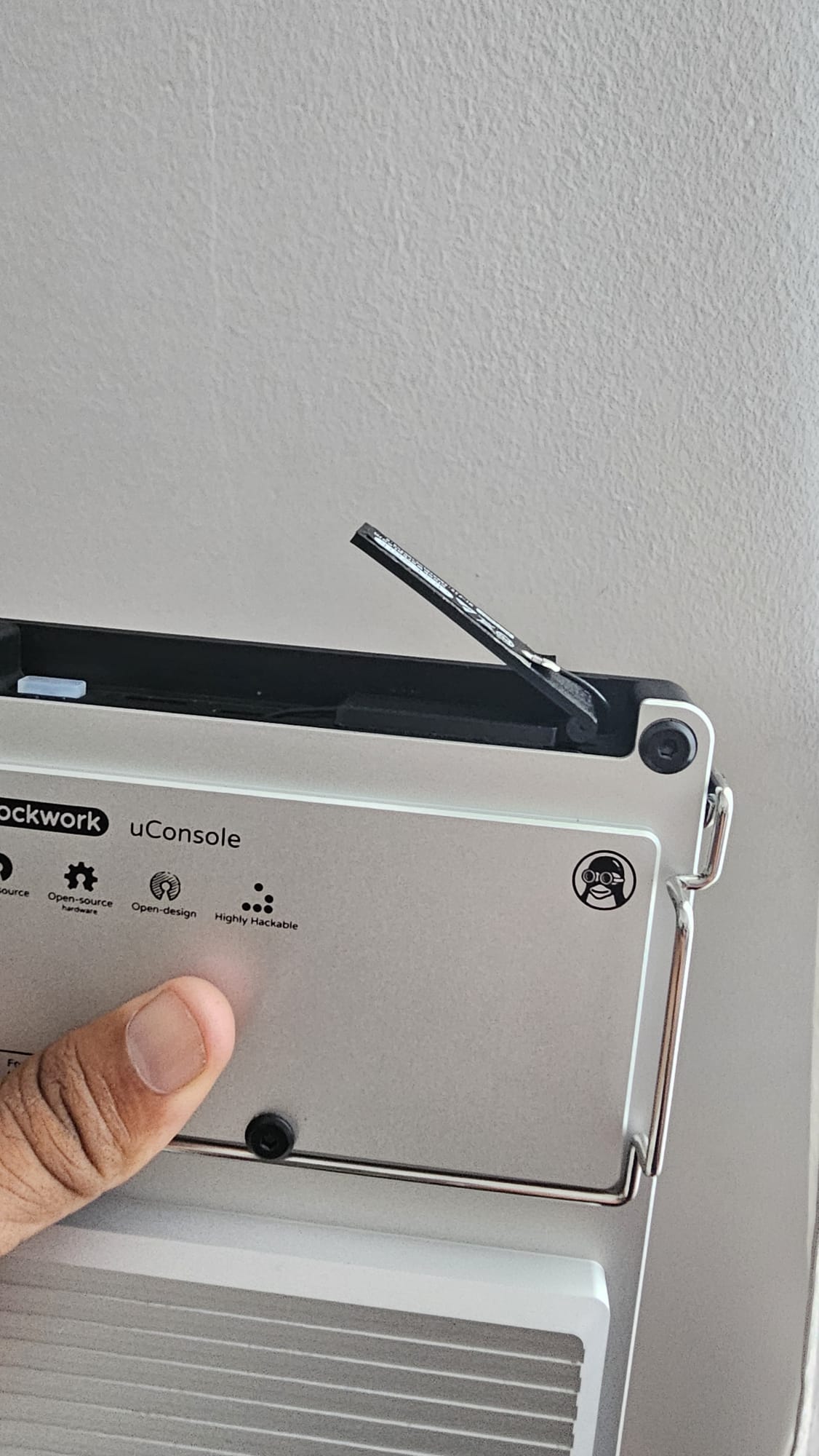

It has two positions:
Folded down – keeps the antenna discreet and protected when not in use.
Folded up – positions the antenna vertically, giving better signal reach.
The model is optimized for 3D printing and easy to install.
No additional modifications to the uConsole are required. Just print, attach (i used double side tape), and enjoy a stronger wireless connection.
