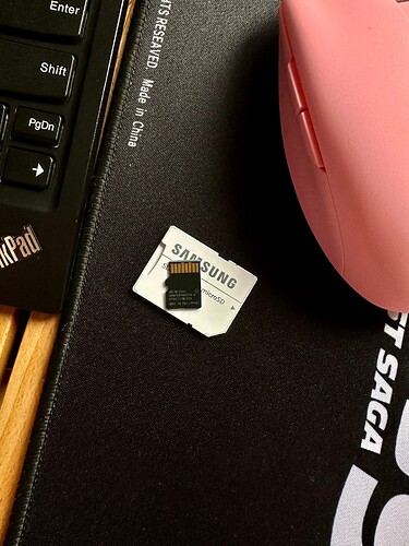

I just assembled my uConsole yesterday, and I’m not sure about the reading and writing speed of uconsole yet.
I bought a Samsung high speed memory card for my device and the pictures are the results of testing it on a usb 3.0 card reader.
The price I bought was RMB ¥212.90, which is about 30 US dollars.
I hope this information is helpful to you.
Thank you for sharing your result.
Maybe you know and I’ve heard that the sd card needs a reader that allows it to reach its maximum read and write on PC.
Reader like this
It seems like that the test you did was on the desktop, right?
Could you try to test your card’s on Uconsole if possible?

It’s not going to matter because the port it connects to on the uConsole is USB 2.0. Plug a USB 3.2 device in, and it will fall back to USB 2.0 because it’s missing the new pins.
The fastest reads you’ll get from the internal SD slot is about 45MBs or so as mike said. So don’t spend to much on a fast card, get reliable.
