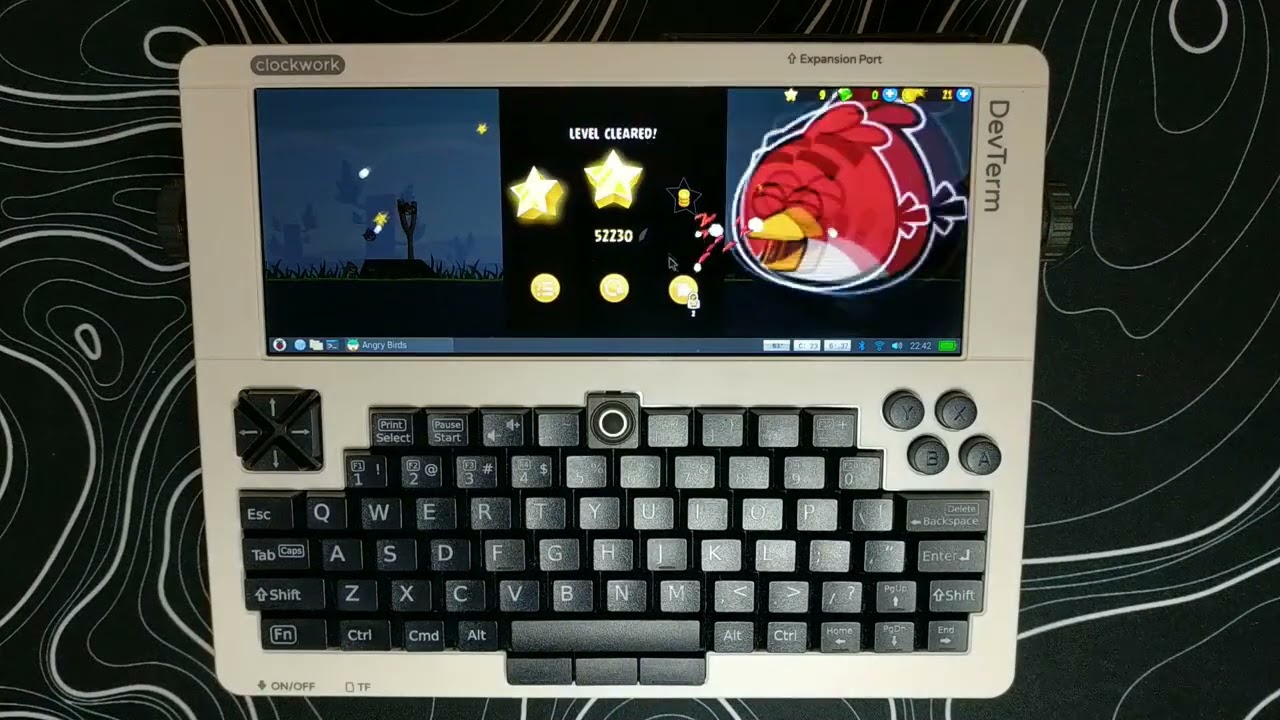

I was asking @Rex on Discord about his projects porting different operating systems to the uConsole, and was curious if LineageOS or Waydroid would be possible. Next thing I knew, he shared a video of Angry Birds running on his DevTerm.
Turns out, Waydroid already works with the kernel in his recent build of Debian Bookworm if you add psi=1 to the end of cmdline.txt. Of course I had to try it out for myself.

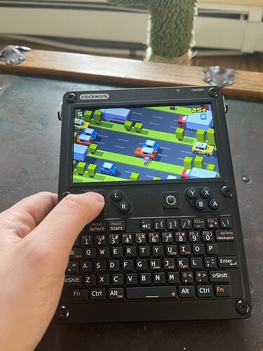

Haven’t thoroughly tested everything but performance seems good! Discord runs well, and I was curious if gentle 3D games like Crossy Road would struggle on the hardware but it seems to play decently. Needless to say this opens up a lot of new possibilities on the uConsole.
Haven’t tried running apps in a window yet instead of running a virtual Android interface but it should work.
Given the similar hardware, I’m guessing this might work on a CM4 DevTerm as well? Won’t have time for a while to check it out, but I was already excited to try Rex’s builds. This just makes me even more impatient and wanting of free time to do it. :slight_smile:
Hopefully the weird resolution of the DevTerm won’t be an issue, though I guess it would work best with an external monitor.
Yep. Rex shared screenshots of it working on his DevTerm.

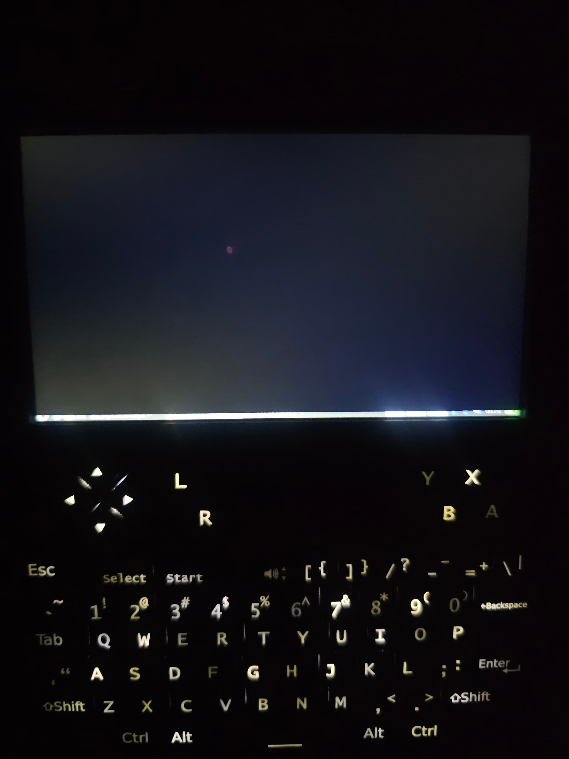

Has anyone encountered the same problem? Running mode droid always keeps a black screen…
waydroid prop set persist.waydroid.multi_windows true
add that then restart waydriod.
Wow, thank you very much, it can start normally.

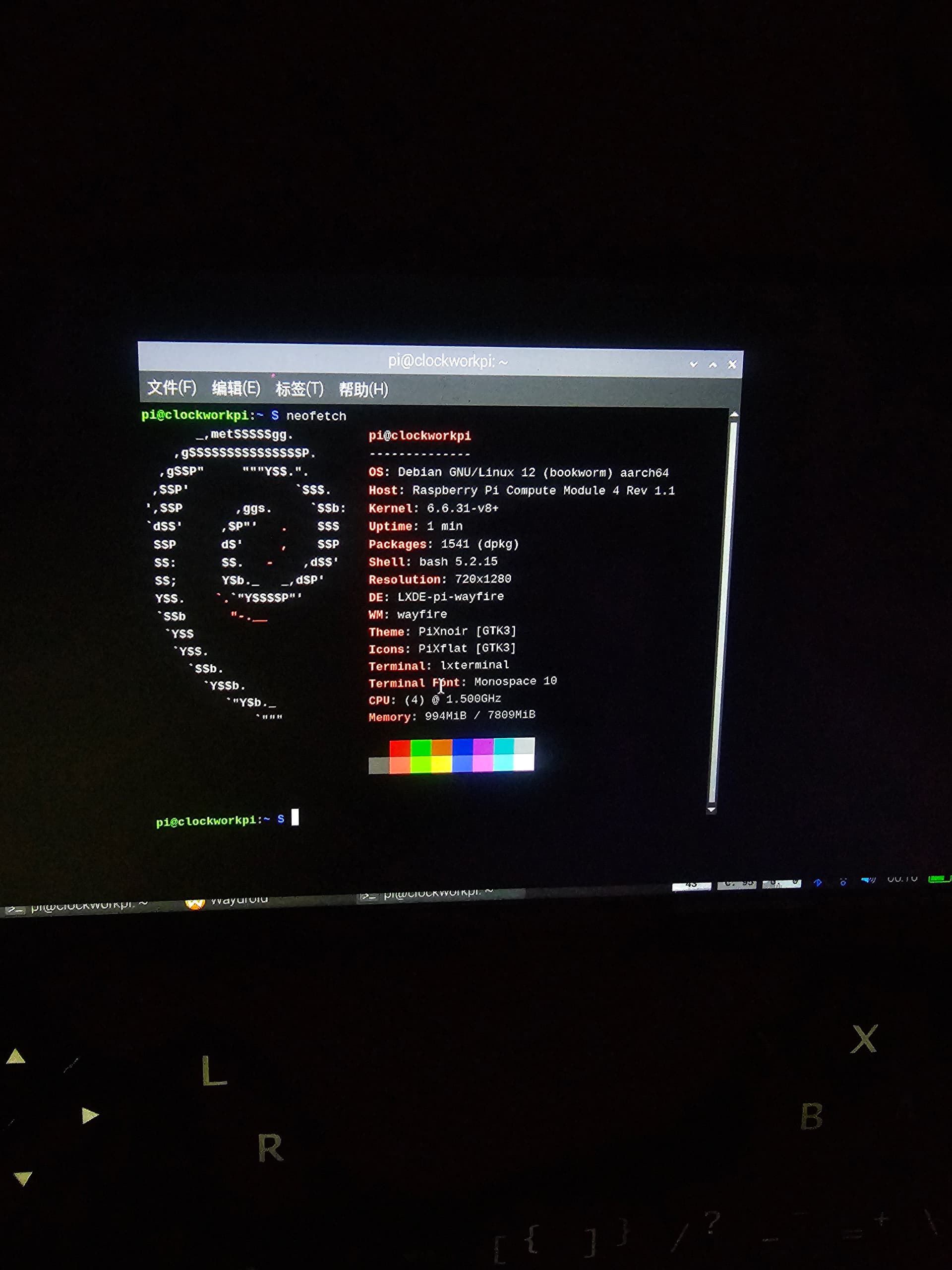

Have tried Waydroid on my uConsole as well after upgraded to kernel 6.6.30 from @Rex and switched to Wayland session. It works at most, the only thing that I currently see is that Waydroid window is not full screen, it is kind of moved up or has incorrect size, even though I set 1280x720 size in properties. I see the part of Linux taskbar. How to fix that…
In Sway, I run the window in full screen with Super + F. Does your DE have a method to fullscreen content?
Oh, you are using Sway, now it is clear. In my case I am in LXDE-pi Wayfire session.
