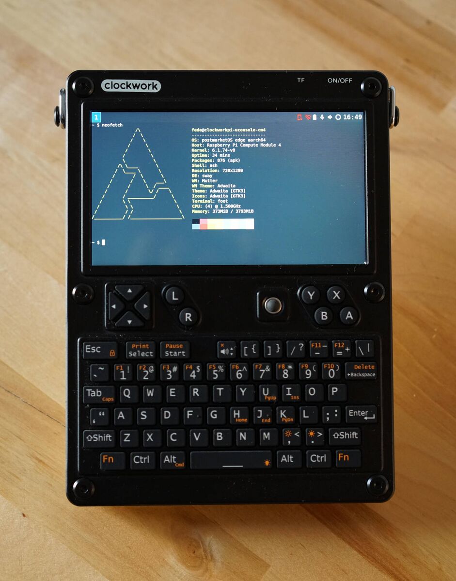

This is the first community maintained distro for the uConsole that I’ve seen in the wild! PostmarketOS is a Linux distro originally made to give carrier-abandoned phones, tablets and Chromebooks a second life. It’s built on top of Alpine Linux and has an option for installing Waydroid for running Android apps. Notably this uses the 6.1.74 kernel, which is much more recent than the uConsole builds we currently have.
You can find the Wiki page with details about current support for the uConsole as well as installation instructions. It looks like it’s an early test build but everything apparently works.
I haven’t booted it yet but I’ll give it a try on my spare SD card this weekend. Currently it looks like you have to build an image using their pmbootstrap utility from another linux computer.
Photo of a uConsole running postmarketOS with the SXMO user interface and neofetch in foreground, taken by Nimayer. CC BY-SA.
