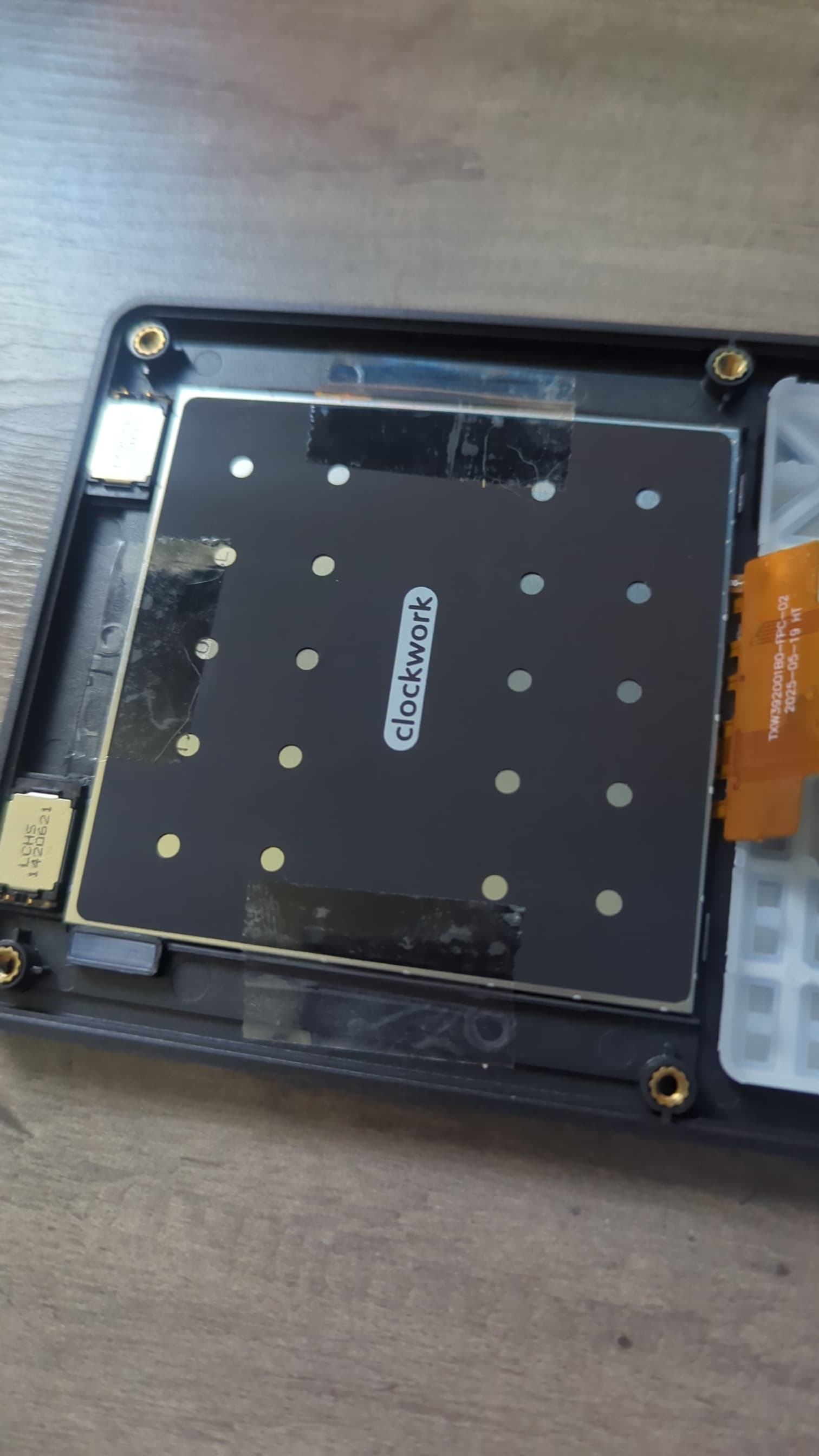

Screen replacement is finally here!

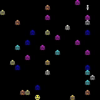

  • Rebound - Zero Zap, but with paddles. Or Pong meets Pinball if you didn’t have a TI-99/4A.
  • Roboworld 2048 - that one arcade game meets that other game you have on your phone. Inspired by a typo.
