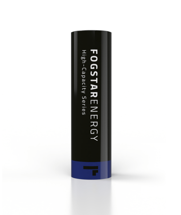

Hi Rex,
I have a quick question i wanted to ask, I use a CM5 Uconsole and ive ran into an issue when charging.
When I have a low battery level if i start charging device whenever I open an application it will take itself off charge for some reason, once i get above 50% it will be fine.
When this happens i can hear a squealing noise which i think is coming from the voltage regulator
I use x2 fogstar 4000mah batteries.
Could there be any reason for this? How can I get around the issue or is it just a byproduct of using the higher power draw of the CM5?
Thanks in advance
