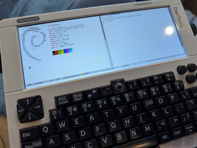

Not sure if you’re still interested in hearing how the 6.12 kernel is working on a CM4, but I just updated my DevTerm this afternoon and it’s running well.
Thanks again for your work on this!
