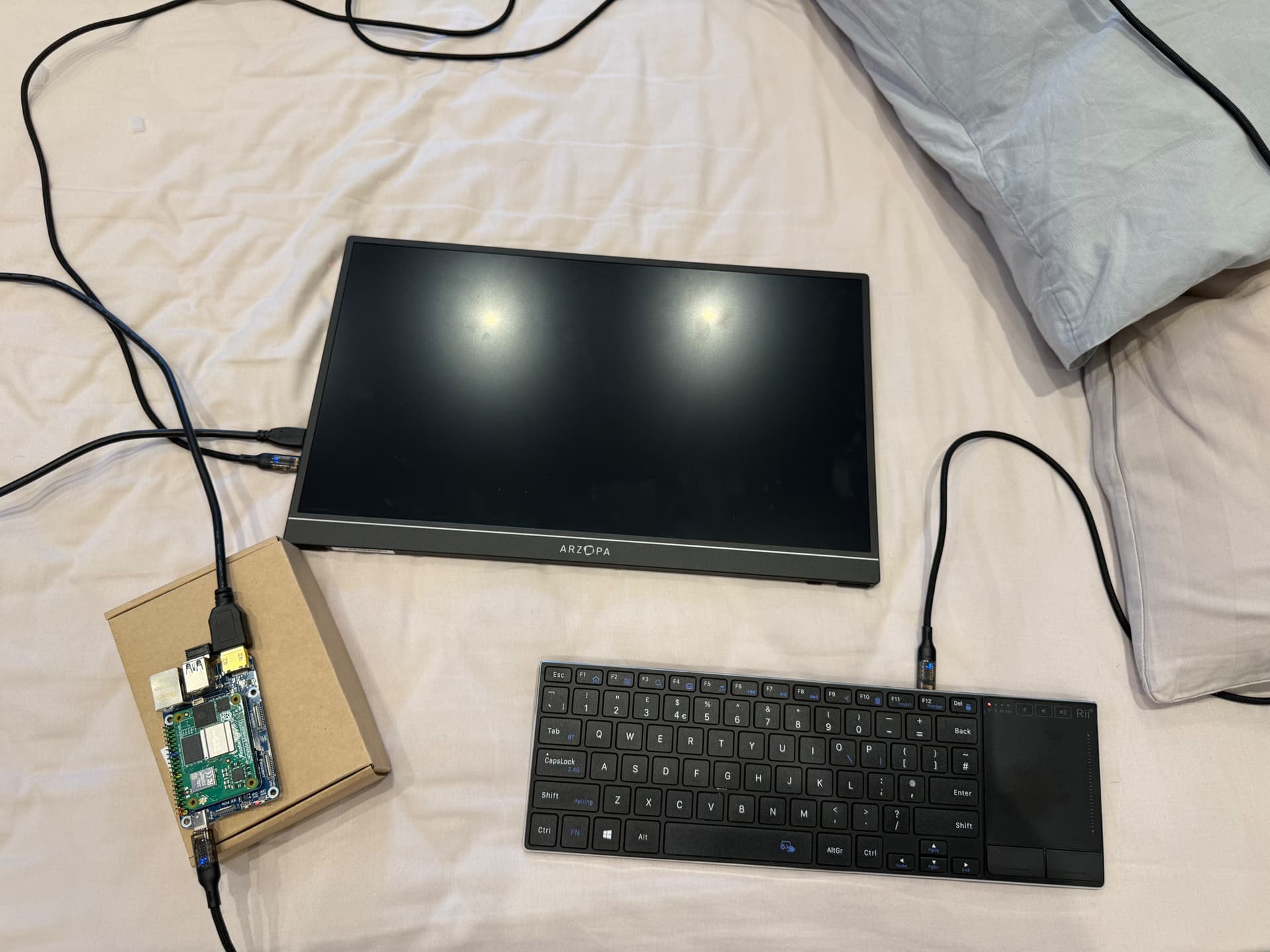

It just will not boot.
I flashed the card using Raspberry Pi Imager - ClockworkPi-Bookworm-6.12.40.img
I changed cmdline.txt to:
console=serial0,115200 console=tty1 root=PARTUUID=545e8bc9-02 rootfstype=ext4 fsck.repair=yes rootwait quiet psi=1 splash plymouth.ignore-serial-consoles cfg80211.ieee80211_regdom=GB systemd.run=/boot/firstrun.sh systemd.run_success_action=reboot systemd.unit=kernel-command-line.target
I think the cmdline.txt file has changed after trying to tboot up
I changed the config.txt file Pi5 section to:
[pi5]
#dtoverlay=clockworkpi-devterm-cm5
#dtoverlay=clockworkpi-uconsole-cm5
dtoverlay=vc4-kms-v3d-pi5,cma-384
dtparam=pciex1=off
dtparam=uart0
I pressed the power button on the waveshare base board a few times but it cuts out and goes red after 3/4 seconds.
I don’t know what else to do.

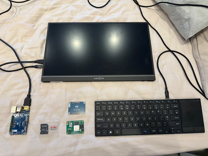

I’m only doing this to ensure the image is working and the card is done right ready for the UConsole.
I’m flashing the official Raspberry Pi OS image to the card right now to check if it boots up correctly.
Will update shortly.
Official OS is working totally fine with saved settings for WiFi. It connected to the internet instantly.
What am I doing wrong with Rex’s image? Should I not save personal settings such as host name and WiFi settings?
