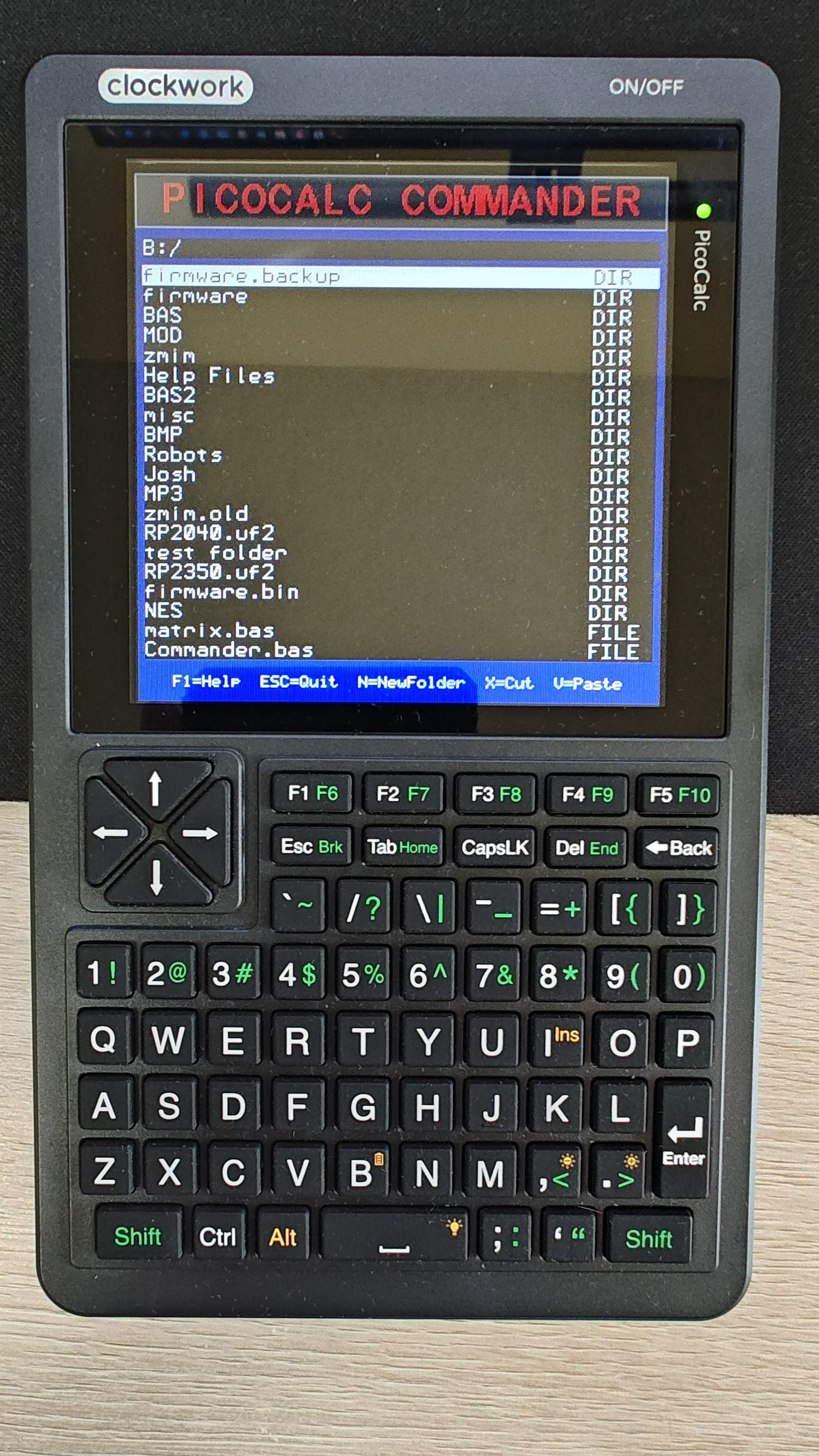

Could someone please test the code?
I have pico mite on an pico2.
' PicoCalc - Commander
Clear
Option BASE 1
Option EXPLICIT
' --- Global Variables ---
Dim fontw = MM.FONTWIDTH
Dim fonth = MM.FONTHEIGHT
Dim bluebg = RGB(0, 0, 200)
Dim white = RGB(255, 255, 255)
Dim black = RGB(0, 0, 0)

I was successfully able to:
  • Switch drives
  • Run a program from root of SD
  • Navigate to a folder and enter it. Run a program from that folder.
  • Navigate to a folder and cut a file with X. Navigate to root of SD and paste.
  • Create a new folder in the root of SD.
  • Delete a file.
  • Delete an empty folder
Couldn’t delete a folder with files and sub folders in it. I get this error:
[269] If UCase$(confirm$) - "Y" Then Kill delname$
Error : FAccess denied due to prohibited access or directory full
I got an error when quitting the program due to this line not being commented out.
=== Subroutine: Help Display ===
This version loads much faster than the earlier version.
Thanks for sharing!

    Select Case UCase$(ch$)
          Case "N"
        newdir$ = ""
        Colour white, RGB(50,50,50)
        Print @(x2, y3) "New folder: ";
        Input newdir$
        If newdir$ <> "" Then Mkdir newdir$
        dirwin$ = "RESTART"
        Exit Function
      Case "D"
        If Left$(p$,1) = "A" Then Drive "B:" Else Drive "A:"
        p$ = Cwd$
        endstate = 1
      Case "X"
        ' === Prevent marking of directories ===
        If Left$(fname$(cursor+ftop-1),1) = "1" Then
          Colour red, darkgray
          Print @(x2, y3) "Cannot cut a folder!"
          ' wait for a key, then redraw
          Do : k$ = Inkey$ : Loop Until k$ <> ""
          endstate = 1
        Else
          ' remember file for copy/move
          copyFile$   = Mid$(fname$(cursor+ftop-1),2)
          copySource$ = p$
          Colour yellow, darkgray
          Print @(x2, y3) "Marked: " + copyFile$
        End If
      Case "V"
        If copyFile$ <> "" Then
          If Right$(copySource$,1) <> "/" Then copySource$ = copySource$ + "/"
          If Right$(p$,1) <> "/" Then p$ = p$ + "/"
          src$ = copySource$ + copyFile$
          dst$ = p$ + copyFile$
          If UCase$(src$) <> UCase$(dst$) Then
            Open src$ For Input As #1
            Open dst$ For Output As #2
            Do While Not EOF(1)
              Line Input #1, line$
              Print #2, line$
            Loop
            Close #1
            Close #2
            Kill src$
          End If
        End If
        copyFile$   = ""
        copySource$ = ""
        endstate = 1
        'dirwin$     = "RESTART"
        'Exit Function
    End Select
