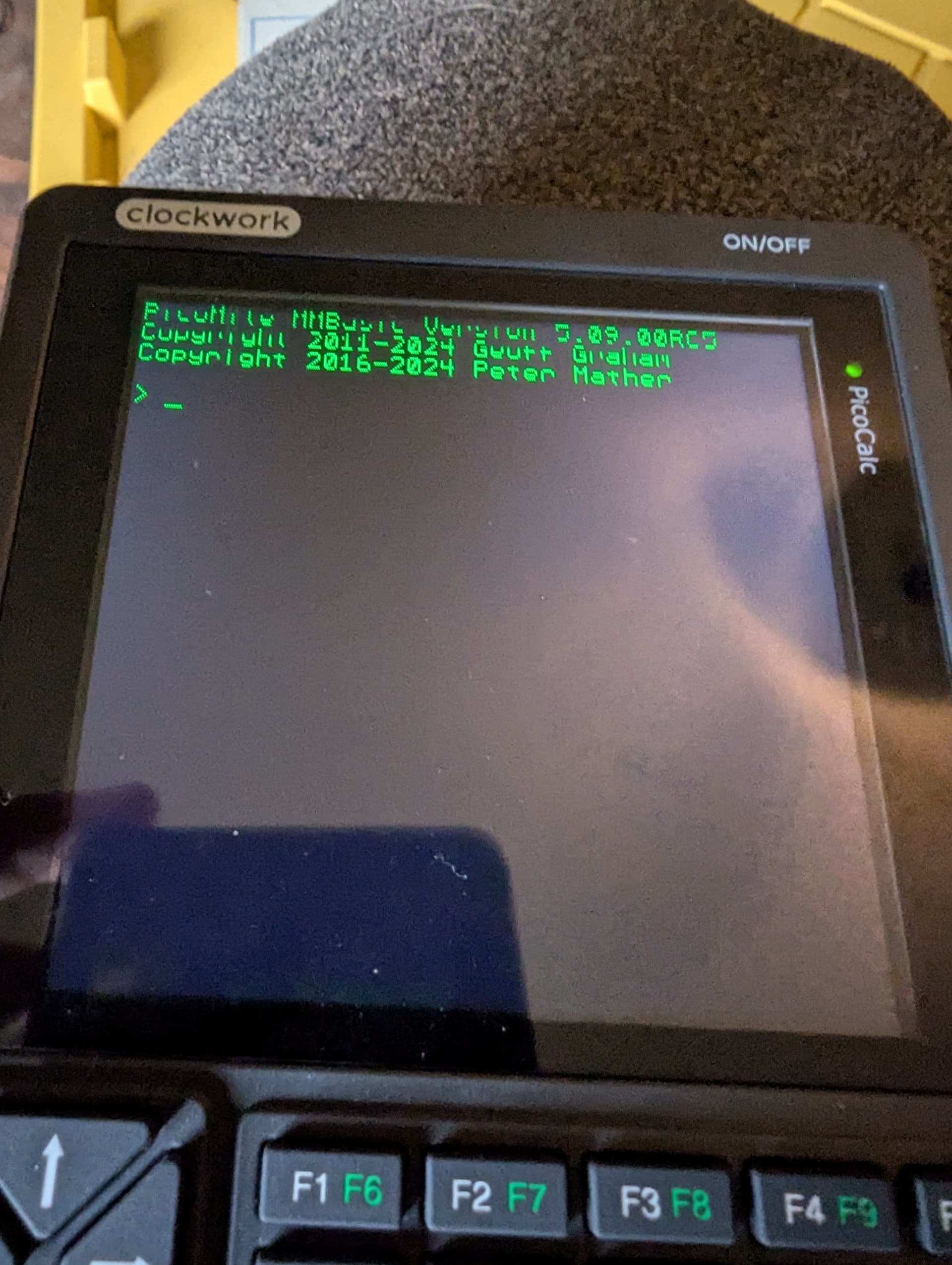

Damaged Ribbon Cable for display

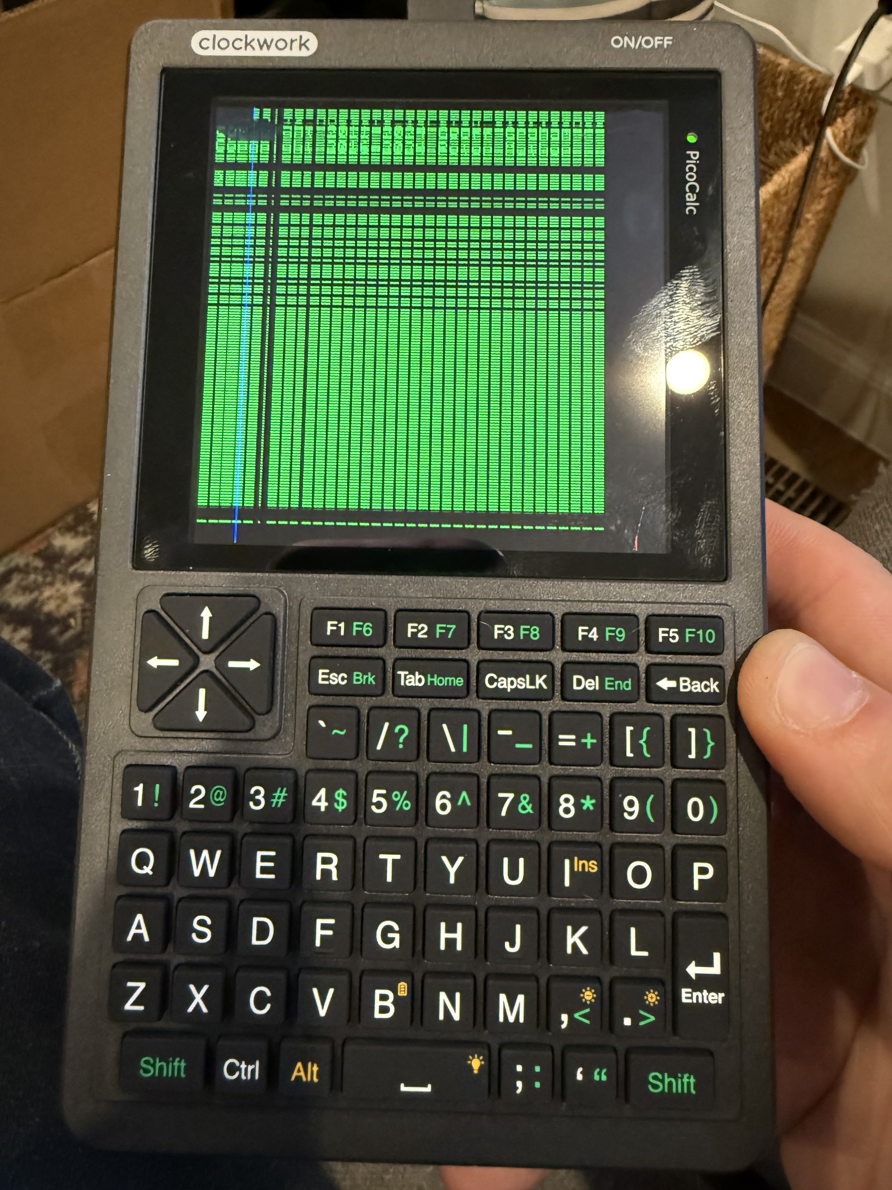

I just got mine and assembled it and yeah I guess mine is from the bad batch too.
Got me too
Yeah I got mine in the mail today with a similar issue fresh out of the box

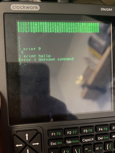

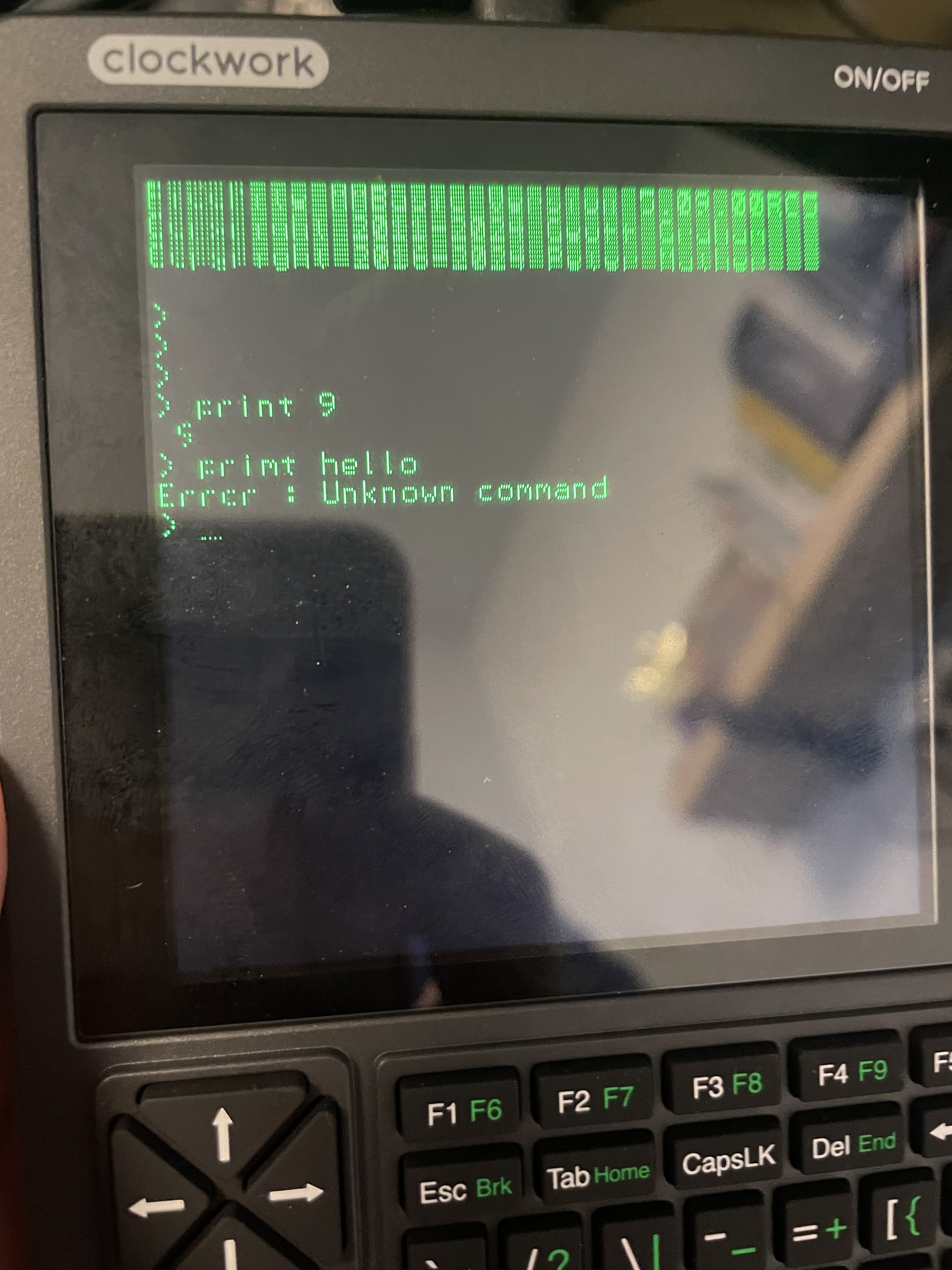

This is the way. What seems to happen is that once you connect the screen ribbon cable to the pcb, it starts to move around whenever the pcb shifts. It it gets lifted, it will sit on those little plastic clips that keep the screen in. That means when you screw down the back, it cracks on the bottom and affects the text as shown.
I has exactly same after my first bootup.
