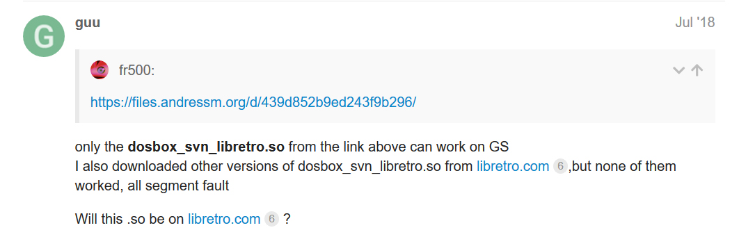

Or does someone still have the working version of dosbox_svn_libretro.so referenced in the post below:

I haven’t built one for CPI.
Can you share a link to your source then so I can try to compile it?
Also there was a link, in another post, pointing to the core but the link is down, do you still have the file?ref
