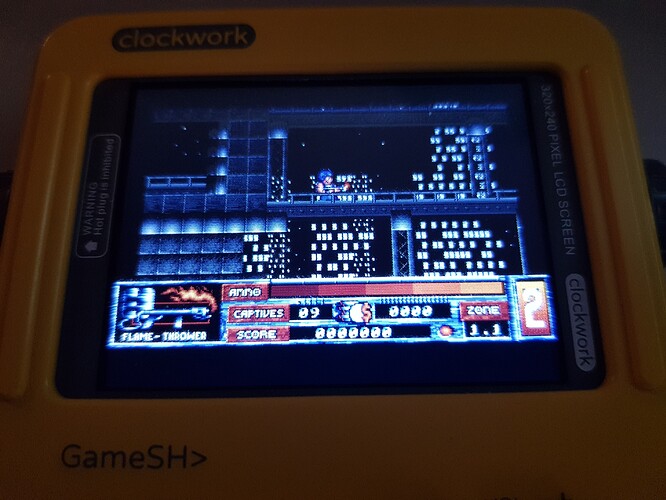

Do you think something like this would work for Alien Carnage (Halloween Harry)? https://www.dosgamesarchive.com/download/alien-carnage/ I have a whole bucket list of dos games from my childhood that I’d love to play on the GS. Some are less intense than others but most are like the one mentioned above. I’d love to play the old duke nukem!
I know the old Duke Nukem works through DosBox on the GameShell. I haven’t tried Alien Carnage yet, but I think I once bought it, so I can try it out.

Finally got around to trying this out and I can’t get it to launch! It just crashes when I click the icon. . . Could you help me out? Here are the the commands I modified from Jazz Jack Rabbit to work for this:
mkdir aliencarnage
cd aliencarnage
wget https://www.image.dosgamesarchive.com/games/acfreew.zip
unzip acfreew.zip
chmod +x aliencarnage
chmod +x CARNAGE.EXE
echo /home/cpi/aliencarnage/CARNAGE.EXE > /home/cpi/apps/launcher/Menu/GameShell/aliencarnage.sh
chmod +x /home/cpi/apps/launcher/Menu/GameShell/aliencarnage
Any help would be very much appreciated especially since it seems like you got it to run!!
Jazz Jackrabbit does not need DosBox if you run OpenJazz.
Alien Carnage and Duke Nukem 1 still need DosBox.
Install DosBox if you have not already:
sudo apt update && sudo apt install dosbox
Create a games directory for Alien Carnage:
mkdir -p /home/cpi/games/aliencarnage
Go to that directory:
cd /home/cpi/games/aliencarnage
Get the Alien Carnage zip:
wget https://image.dosgamesarchive.com/games/acfreew.zip
Unzip it:
unzip acfreew.zip
Create a menu link that utilizes DosBox:
echo 'dosbox ~/games/aliencarnage/CARNAGE.EXE -exit -exit' > /home/cpi/apps/launcher/Menu/GameShell/aliencarnage.sh
Reboot and let me know if it runs.
After that I can help you to set the DosBox settings right for video and controls. The resolution will be wrong in the beginning!

Works! Thanks so much!! Yeah I messed with the .conf file for dos box to try to figure out the resolution and couldn’t get it. If you could let me know how to do it, that would be very much appreciated!!
OH wait… . . I saw you already said that stuff at the top of the thread.The dosbox -startmapper also can’t be run from an ssh session so I’m not sure how you launched that command from the GameShell. There was a brief screen for mapping up, down, left, right and thrust but nothing for changing weapons or stuff like that. Thanks again for helping out!!
In the dosbox config file (located in /home/cpi/.dosbox) change the full screen res to 320x240 and below that change output to opengl
In a section below that, change offset to true. (I think it’s offset. I’m not around my computer to check lol)
Because you launched DosBox, it created the folder .dosbox with in it dosbox-0.7.4.conf.
Here are my video settings: dosbox-0.74.conf
You are right. I cheated.
I installed DosBox on my (Linux) PC and created the file:
mapper-0.74.map
You can put that in your .dosbox directory. It uses the configuration I posted earlier.
I have not mapped the key_s to select Sound Blaster in Alien Carnage. Anyone selected Sound Blaster yet?
I use my mapper-0.74.map for all my DosBox games.
When asked:
Are you sure you want to quit (Y/N)?
I press Shift-Y.
