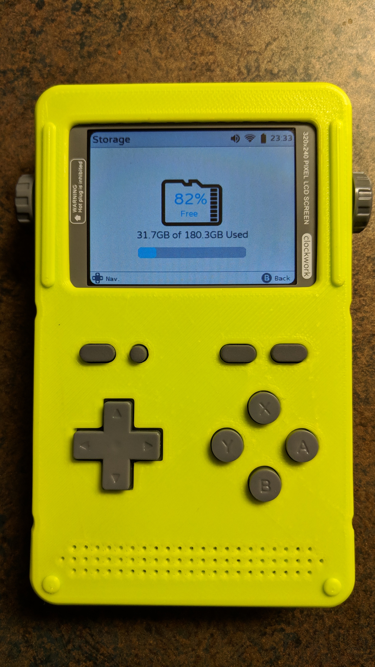

Thanks for all the help on this thread. Had a bit of growing pains moving through the steps, but got the 200GB card recognized. Overkill? Yeah, I’m gonna fill it up anyway. Will update on any negative performance issues as it stores more bits. But I don’t think I’ll get there anytime soon.
Here’s my tool list and quick steps for the process I used.
  1. Download ClockworkPi image. Write to SD card w/ Etcher on a Win10 machine.
  2. Loaded up a Virtual Box VM w/ Ubuntu and attached the drive. Yup, only partitioned 8GB.
  3. Used gParted to extend the partition to the max. Takes a while. Eject USB when done.
  4. Plug SD into GameShell, check out storage settings. Boom goes the dynamite.
IMG_20181007_233424
You can help add another data point. Try to load as much content as you can and let us know if you experience any issues. If you can, try adding some additional consoles to the home screen with a significant library as well. Glad we were able to help! I’m sure as time goes on we can streamline this process. Some of these tools can be rewritten for the gameshell the way they have for the RaspiConfig menu on the Pi.
