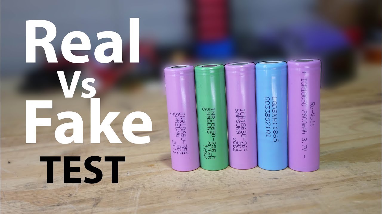

Based purely on past experience I like the Panasonic NCR 18650B. That battery was not tested in the video but I was surprised that the Japanese Pana/Sanyo did as poorly as they did.
Edit
(Edit: I’m removing this comment because it can be taken out of context. I use battery cells in industrial/medical devices; consumer electronics can use cells with 30+ or 40+ Milli-ohms of resistance.)
I will say that when I probe a battery and it’s internal resistance is over 25 mOh I start to consider it “not fit for use”. So if I had a new battery in my shop and it’s life started at over 20 I would send right to the recycling bin.
6 of the batteries claimed to be “brand new” but are either built with poor materials and quality controls or are used batteries that some one is selling on the second hand market as if they are new. (Sometimes pealing off the old shrink rap and replacing it with a rapper claiming 9999mAh lol)

Just in case someone runs across this thread later, my A06 DevTerm has 5800mAh batteries in it, and the Ubuntu menubar battery widget estimates 8 hours of battery life.
Running two 3500mAh cells and also getting the 8 hour estimate. Anything above 3600mAh is a made-up number.
Yep, I bought some ‘9900’ mAh batteries early on… I think its off by a decimal place so they are like 9900 x 10e-1 mAh …safer bet is to buy from a reputable source rather than Amazon… next you’ll ask me who and I’ll have to research my thread. I need to go and recharge mine since I’ve had them so long anticipation of the unit arriving.
The best way to know the exact capacity of a battery is to have a proper charger that give you how much energy it put inside the battery.
Will not recommend any specific brand, but they are reasonably easy to find.
The best are of course the one that directly support the 18650 batteries without an adapter
