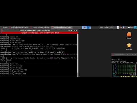

Here’s a really boring video of me performing common tasks on the A06. The interesting part is on the bottom right showing CPU info and temps.
File manager & terminal 65C, firefox youtube start 80c, youtube play 75C, 6 core compile 80C.
I also have the data log with graphs here: https://docs.google.com/spreadsheets/d/1ceBsWNVOawpDTacxXP08zW7-d3T6AmZcM3wOd9zvaoo/edit?usp=sharing
(kazam screen recording uses 200mA)
Clarification - in gear 6 with the flexible metal case-mounted heatsink that’s now shipping.
