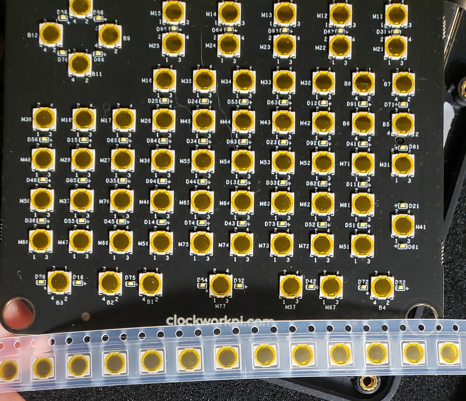

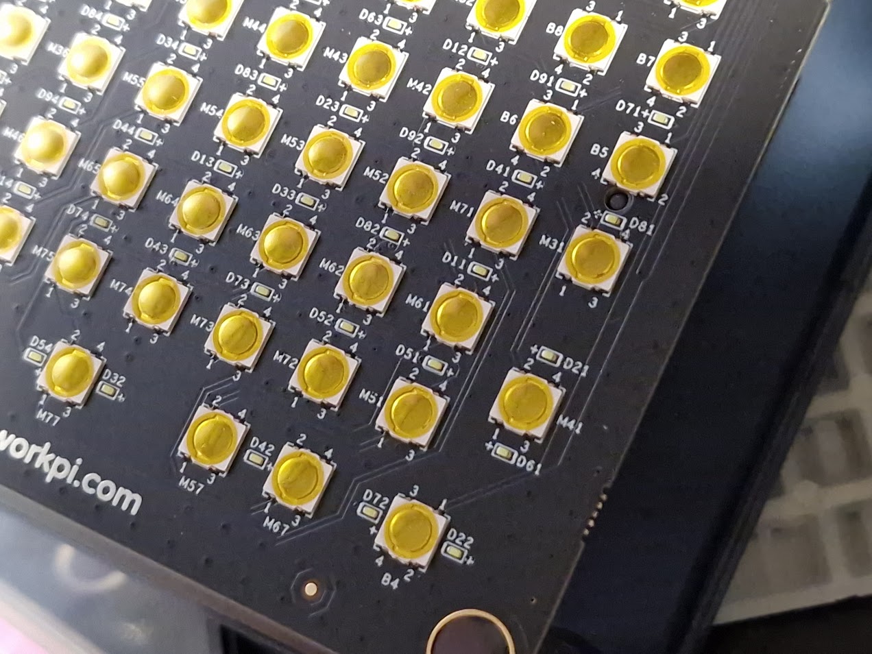

here’s a closer look at the switches for further reference, i measured roughly 4.7-5mm to a side, 0.5mm depth
i couldn’t find ones that look exactly the same on aliexpress, these are the closest ones (the 4*4*0.8 option) https://www.aliexpress.com/item/1005006486926948.html
not yet sure if i’ll go through with an attempt to replace the switches (simply due to effort, i’ve done this kind of SMD before) but figured i’d at least document this far :slight_smile:

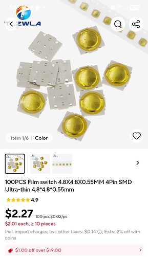

I’ve looked a week or so ago, and found one that looks like a match, but the seller had the nerve to ask $15 for just one.
Just didn’t an image search and found something really close on AliExpress, and with the dimensions I was expecting, 4.8mm × 4.8mm × .55mm, and cheap.

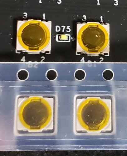

I recieved they switches, and the do appear to be an exact match!
I put a tiny dot of super glue on each dome, raising it by a couple mm. Now the keys don’t have to be pressed quite so far to register.
Personally I wouldn’t quite recommend the Super glue trick, unless you have extremely precise hands, and perhaps tools to get a precise amount of glue dead-center. Mine still works but seems even flakier now and the dome for the space bar key is loose, but I think I got it held in place with the case shut.
Maybe I’ll see about a replacement board of AliExpress or something someday. But at least now I can say someone has tried it and can tell people it’s not a good idea.
