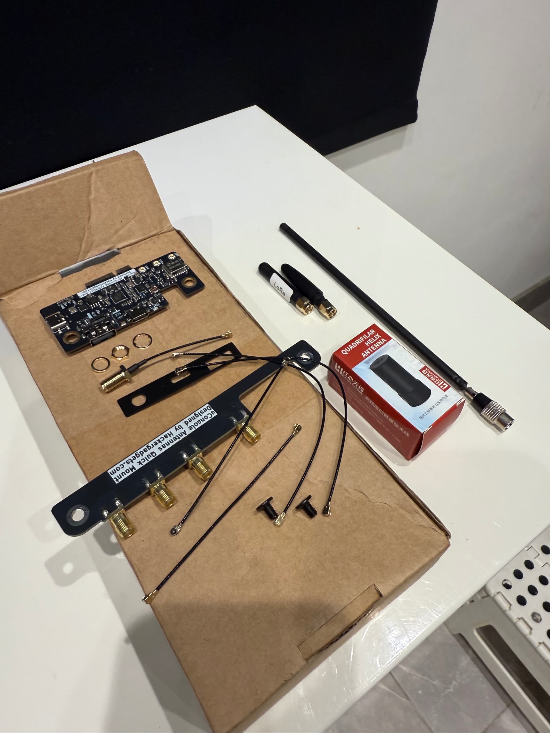

I just received my full kit.
Time to get busy.
Someone please tell me the right order of the antenna washers. I hate it when the antennas don’t sit properly.
since you have the antenna board, you don’t really need the side antenna
Yes, that I understand but I want to know the order of these washers.
I’m sure they are all for the WiFi antenna

I am pretty sure these are all for the side antenna connector, which I initially put the long SDR antenna on, but I’ve now removed the side antenna SMA connector as I have all the four antennas along the top and don’t currently plan to use the side opening.

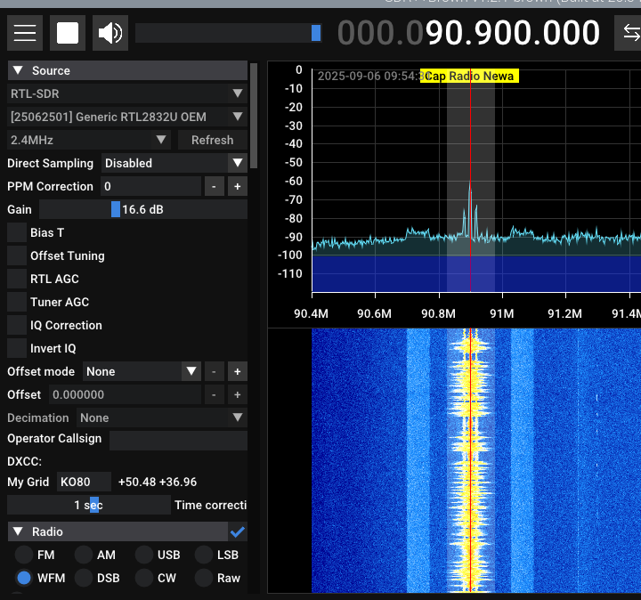

I reinstalled the new Trixie image and now I cannot hear output from SDR++ Brown. Everything looks normal but there is just no sound from the speakers. The only thing I changed from previous installs is that I installed @Rex’s SDRTrunk package. Could there be a conflict between these two packages, or did I forget some setting on SDR++ Brown?
