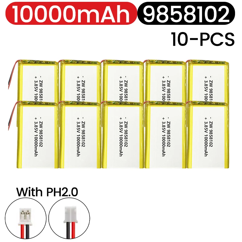

I am testing this Lipo battery on a CM4 setup. Battery wires were reversed so soon sorted that out. Seems to be working well so far its a 10,000Mah setup. I will fully charge and discharge to see how long it lasts. So the battery i used is in the link and looking at reviews someone already tested on Uconsole CM5 and works fine see pic.
I just found this on AliExpress:
9858102 High Capacity 10000mah 3.7V Battery+PCB Protection Board Rechargeable Flat Battery Laptop Batteries Power Bank
You would have to splice/solder the batteries in parallel with respect to their polarities; and have a thicker gauge wire from the splice to the connector.
That was my original idea but your need to do some work.
