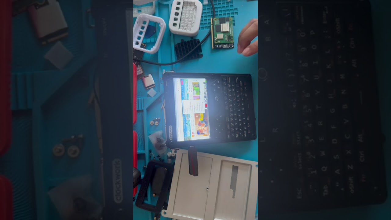

faild,screen back light on,chip hot!no other action!!! l need sleep for a long time!! byebye

yes two board is nessary!but failed ,l try to find problems!!
after l success!!!
@Rex fails again !but some problem Found!wait for next try!!
This time same problem had likes last time!!
Below is BAD news (not too bad):
1.Screen doesn’t works(backlight works but no imagine)!
2.USB doesn’t work(DP and DN wrong positions)
3.HDMI doesn’t works
Solve way:
1.copy console “DSI” line in PCB 1:1(this is the best way, maybe the PCB map is wrong I need check first, new find one pair MIPI is wrong position)
2.DP and DP (change positions 100)
3.some ground lines don’t connect(l need fix the ground lines)
Well news:
1.SD card works well!!!
2.ssh works well(cm5 and cm4 can works well)
final:
l will take this in six floors pinels!(UC `s original is 4)
see you ten days later!!
@neocska92 do you have time&interests help me ?thks
@Rex l fix the two problems(mipi&usb),now success first !!!wait for me 10 days!!
10days is Ethernet&pcie!!
