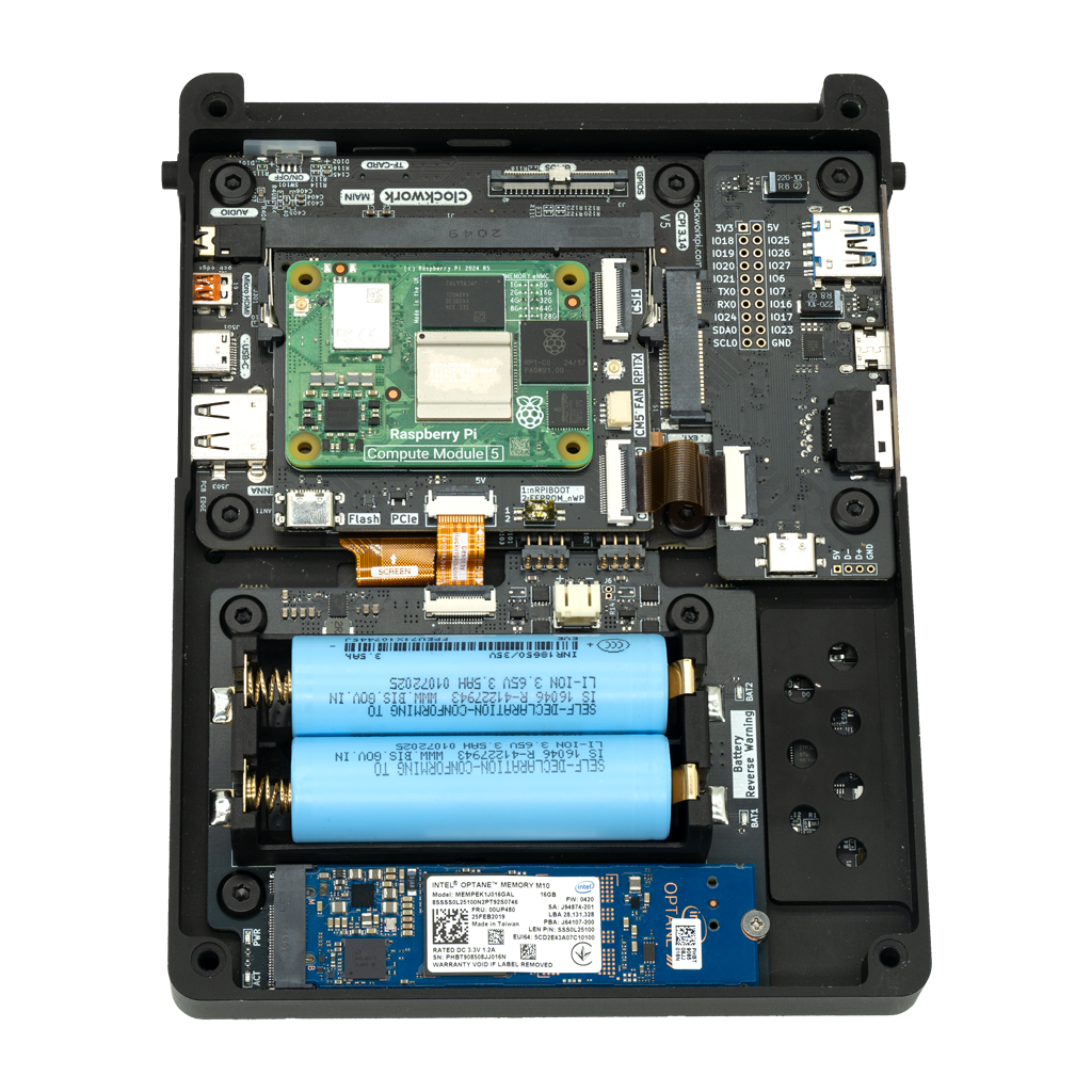

I think I want this adapter board for the nvme drive. Couple of basic questions before I pony up:
  1. I can’t get an nvme with a heatsink or the back case won’t fit, correct? The back case still fits fine?
  2. With the modification of the eeprom, this will allow me to bypass the SD card and boot from said nvme? I did this with my Hackberry Pi and the results were noticably better.

If the height of the NVMe PCB + the heatsink is less than 5mm, it will fit, or it won’t.
Yes.

just an FYI about the nvme heatsinks, if your running an nvme drive at pcie gen2/3 and only one lane they won’t get very hot. I wouldn’t bother with a heatsink

What kind of solution do you guys recomend for cooling a cm5 with this setup?
I have a m.2 heatsink slapped on the back cover and it helps quite a bit. I get no thermal throttling, max temps I get are 60 when I’m pushing the device hard. The case does get a little warm during that time but not to were it’s uncomfortable.
