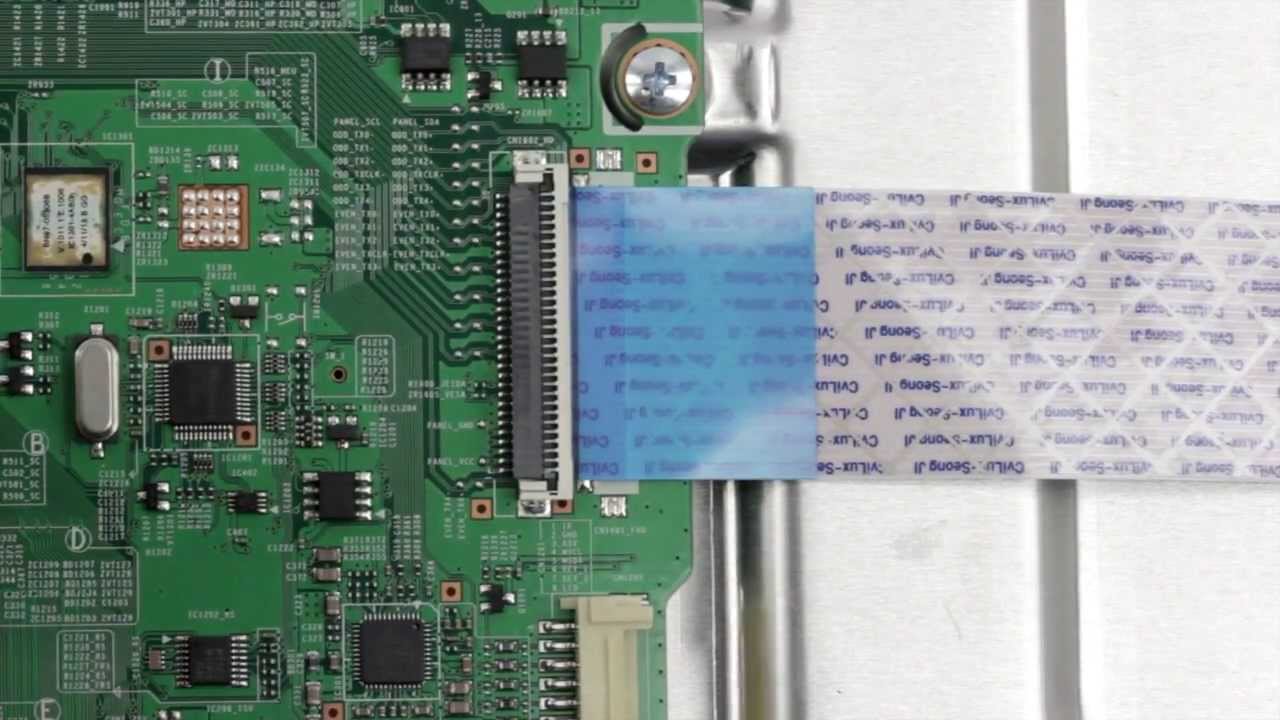

I just receive my A06 and I try to mount it. But I encounter a problem with the screen. At the and, I try to start devterm only with a phone power supply (Not 18650, I don’t found theses battery on shop :confused: ) and screen don:'t start. I think the problem is with connector because I don’t know how I can connect this…
I correctly connected the connector or I need to insert this deeper ? (I don;'t know how, I’m afraid to break this part :confused: )

I can´t see very well from the photo but the white plastic with the black thing
The black thing is a lid that goes up so you can insert the flex cable, and then you need to push it down until it clicks and holds the cable.

It’s normal if the flex cable is not flat ? :confused:

Hum, it’s not flat but I can mount the devterm

Yes its okay that its not flat, that will also happen with the printer cable.
As long as it doesn´t get into the way of other pieces or gets smashed is all good.
