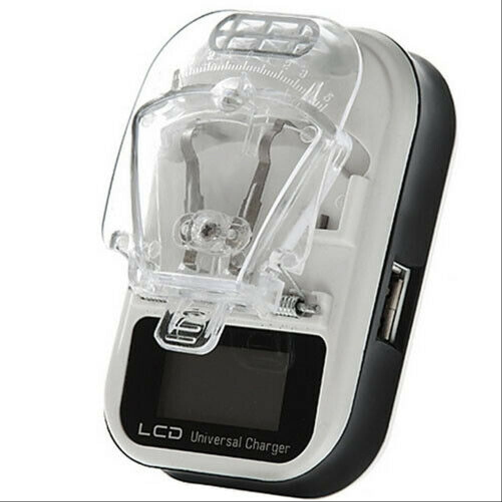

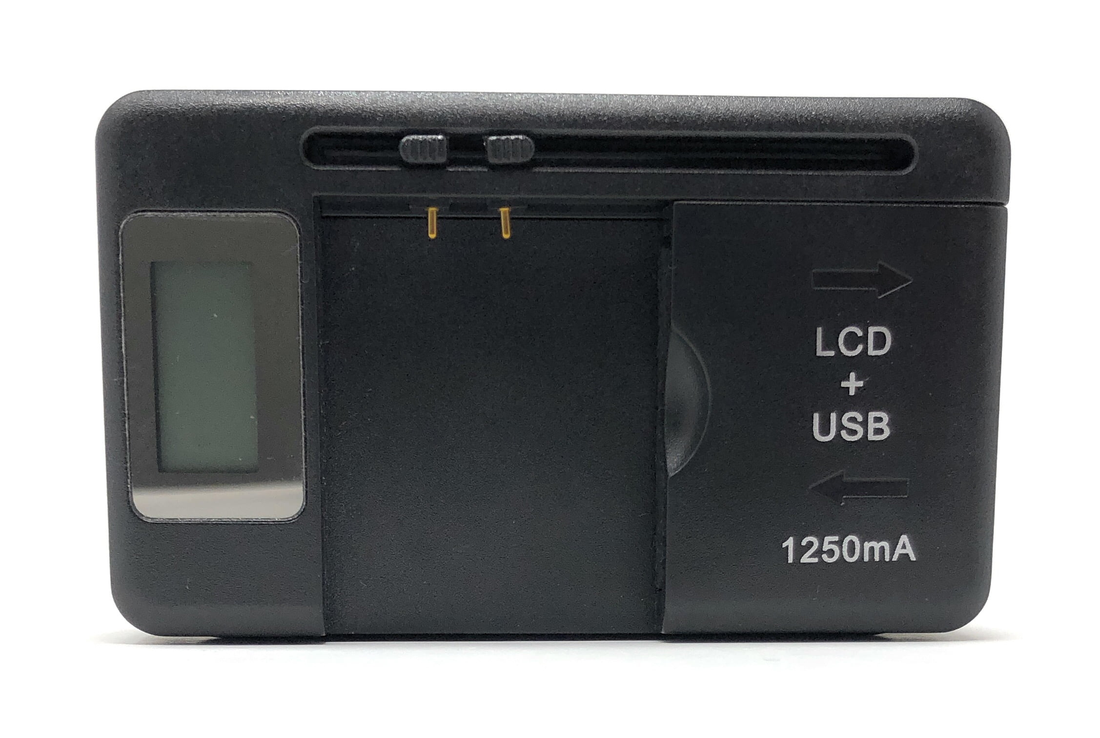

I looked around a bit and came up with these:
Would one of these work well or is there something else you’d recommend using instead?
The battery type in the Gameshell is a “BL-5C” which is a standard Nokia-style battery.
As mentioned you could get any universal charger for BL-5C and charge using that.
Take a look on ebay, you could probably get a charger and second battery for <$15
