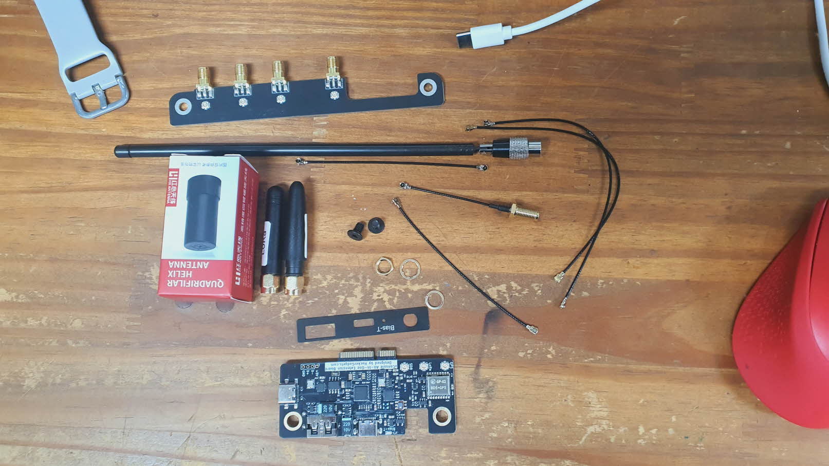

Any soldering involved to attach the CM-5?
Are you using the same board?
I’m in the same boat you are. I bought a lCM4 Lite and ordered a CM5 along with the Hacker Gadgets antenna expansion and a upgrade board also from HG that someone here recommended.
Unless you are doing some exotic things, no soldering required at all. The Compute Modules just click in.Same with the hackergadgets stuff.
Thanks for the accurate and calm information. I’m not a Linux expert, so if someone gives me a quick explanation, I’m not really getting it.
At first, I was thinking of separating it into partitions, but I think it would be right to use a separate device. Thanks for the good information
It says it’s for cm4, but you can use it as it is without deformation even in cm5.
