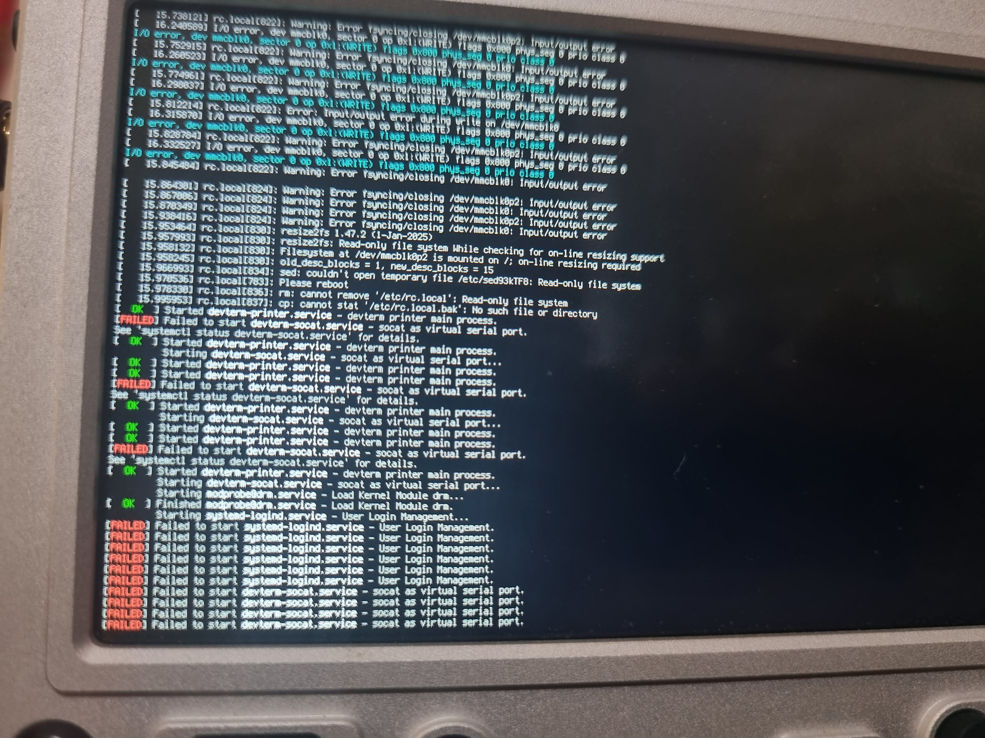

Either the SD card is borked, or the image you flashed was corrupt.
mmcblk0p2: Input/output error means the kernel is trying to read from the storage device and is recieving nothing but errors, and remounting as read only is not a great sign.
Are you sure, like 100% certain, that this is a genuine 256G card from a reputable manufacturer?

can you check sdcard for bad sectors?
