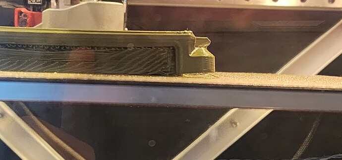

Okay, on the back pieces, you need a brim on the two “feet” on the bottom of the housing.
Noooop. Touch too small.
I can’t measure the length, my calipers aren’t long enough, but the width is about a mm narrower than the uConsole. Looks like the STL of the console is a touch off, which isn’t surprising.
I’ll have to update it when I have an actual devterm to take dimensions, can you quickly try printing a 10 mm cube and let me know if your printer has any dimension shift?
Yea, printer prints sizes correctly. It’s one of the troubleshooting steps I ask folks when they can’t get their mpcnc parts to fit cottectly.
