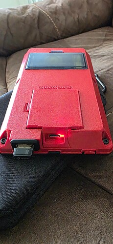

whats the connector type on the top? Is it JST or micro SH or what? wanted to make a connector to USB.
These attach to that MX 1.25 on the top of the Lyra and gives you a USB port. If you don’t want to mod your case, It is short enough that you can loop it down under the battery and keep it entirely internal. I had no trouble attaching a wifi dongle to it in this manner.
Wifi has gone internal seems to work perfectly fine inside. And Antenna mount is ready for a LoRa board.
