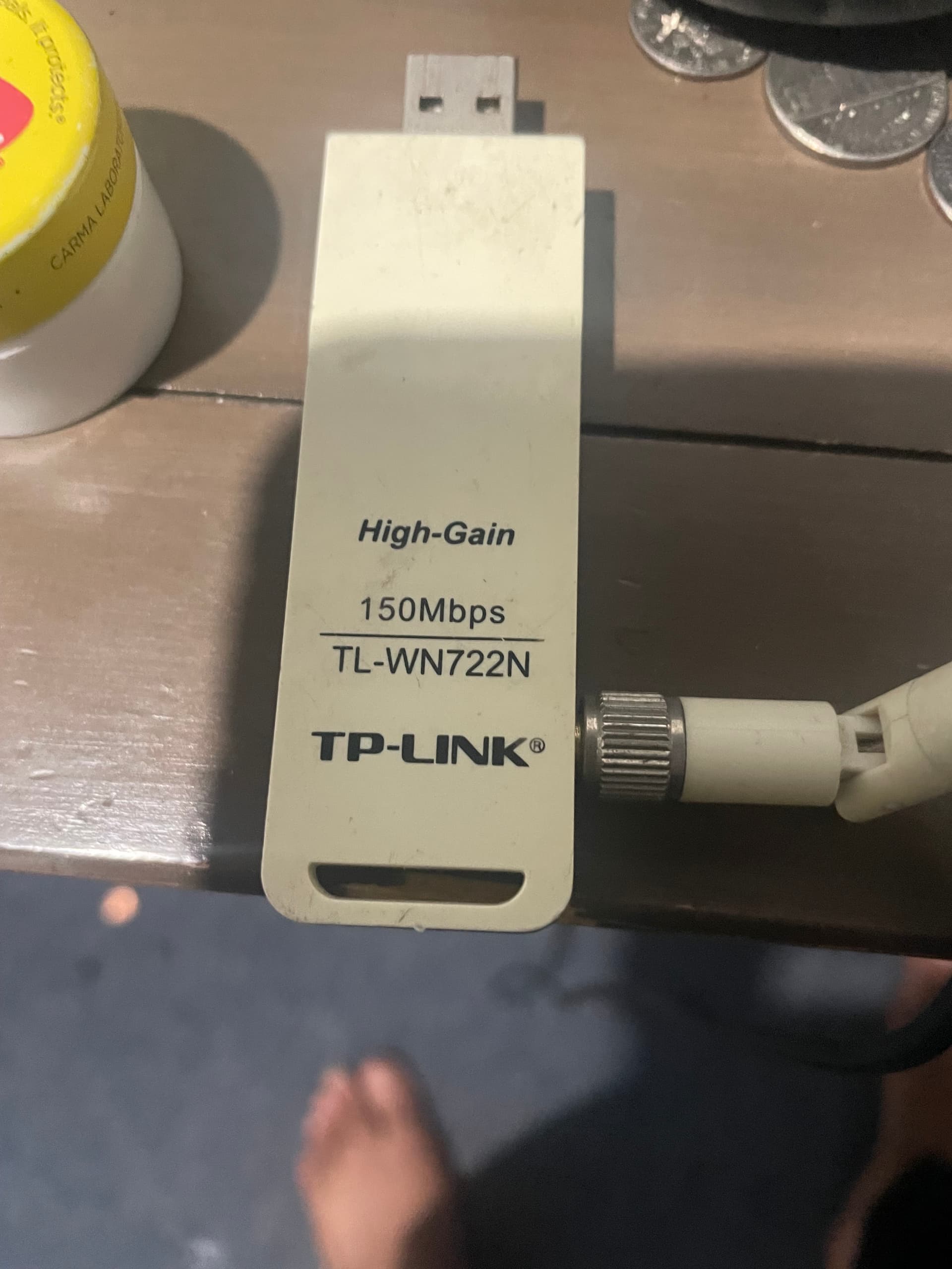

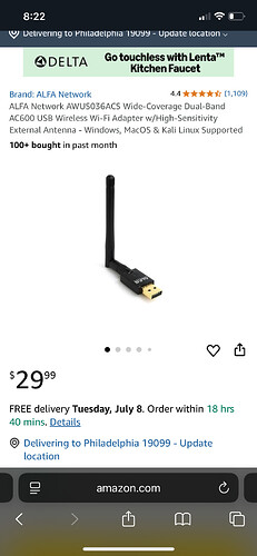

Do you think this one would work , the other one I showed at first doesn’t seem to show up anywhere and the default wlan0 interface on the kali device doesn’t work
I’m not sure, it all depends on what chipset it has and if it can switch modes. There should be a site out there that lists the ones that do.
mediatek, skip realtek.
That will support monitor if it’s a V1 adapter. All the newer versions are realtek.
