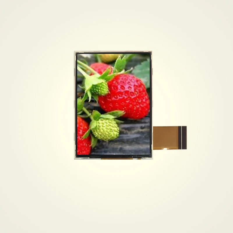

Here is a LCD, sorry TFT, module pretty close to the one on the GameShell, and guess what?
That’s an IPS.
The one for the GS or the DevTerm? But i’m pretty sure the GameShell does not have an IPS display.
That’s the gameshell one.
Oh right, I just was looking in the forums, so in 2019 you did an IPS instead of lcd right?
IPS, LCD and TFT are three different things.
IPS == In Plane Switching
That’s how the segment in the panel are layout
TFT == Thin Film Transistor
That’s the technology of transistor used on display panels
LCD == Liquid Crystal Display
A technology of display panel using liquid crystals.
All modern LCD use TFT, in fact lots of people nowadays call a LCD a TFT, it’s neither correct or incorrect, but you can use them interchangeably.
IPS, is one among a lot of way to layout the segments on a LCD panel (the segment being what make the pixels and subpixels of the display.
Saying 'IPS" instead of LCD is on other hand incorrect. All IPS display are LCD. But all LCD are not IPS. There are other way like TN, VA, … for example.
The screen on the GameShell is the same since the device was made first send to the Kickstarter Backers as far as I know.
One good way to check if a screen is an IPS and not a VA or TN is the angle of vision. IPS tend to be better than the other one on that aspect.
