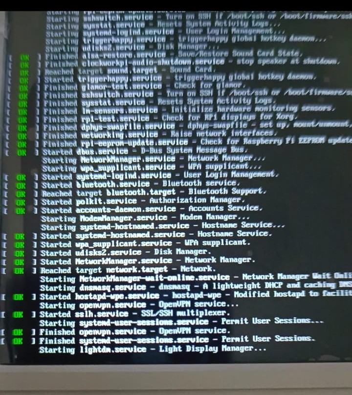

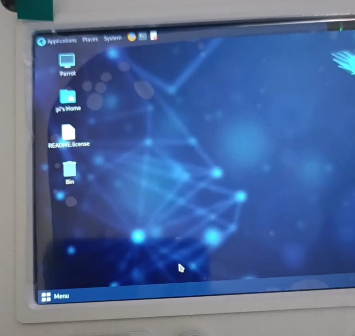

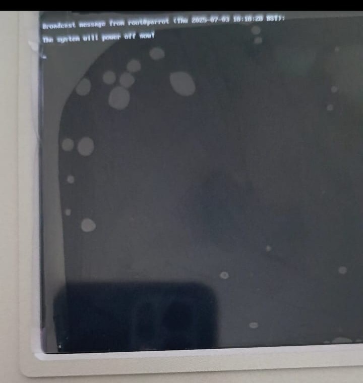

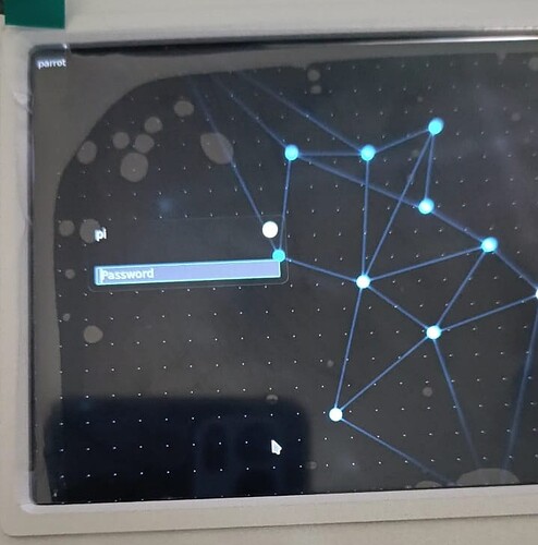

Hi Rex, sorry to bother you. In the photos I’ve attached, you can see what happened to me as soon as I started up the uConsole with the Lexar 633x 64GB micro SD card. As soon as I start up the machine, the OS only runs for a few seconds before shutting down, even though I haven’t made any changes to the settings, including the Wi-Fi settings. I simply downloaded your image, unzipped it, and used Rufus to put the image on the SD card. Then I inserted the card into its slot and started the machine… then I don’t know what could have happened.
it should restart once after fresh installation and first boot.
okay, everything’s sorted
on first boot, the device boots, resizes the file system to fill the sd, then reboots.
