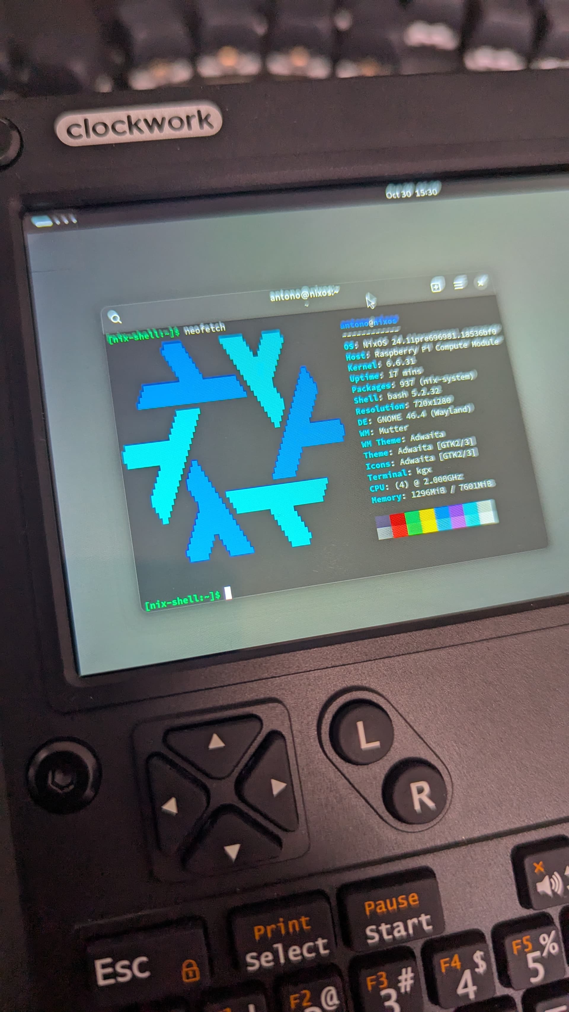

Hello,
just committed the preliminary version of my attend to bring NixOS to uC.
found small issue: sometimes screen do not turn on on the cold-power-on. fix: just ssh to the box and make a reboot.

Hello,
Just a quick image for NixOS-uConsole (for the experienced users) with the custom kernel and some preinstalled tools (wireless, git, etc).
Quick HOWTO:
- Download, unpack, write to SD.
- remember to make your own config based on repo uconsole/sd-image-uConsole.nix
have fun!
