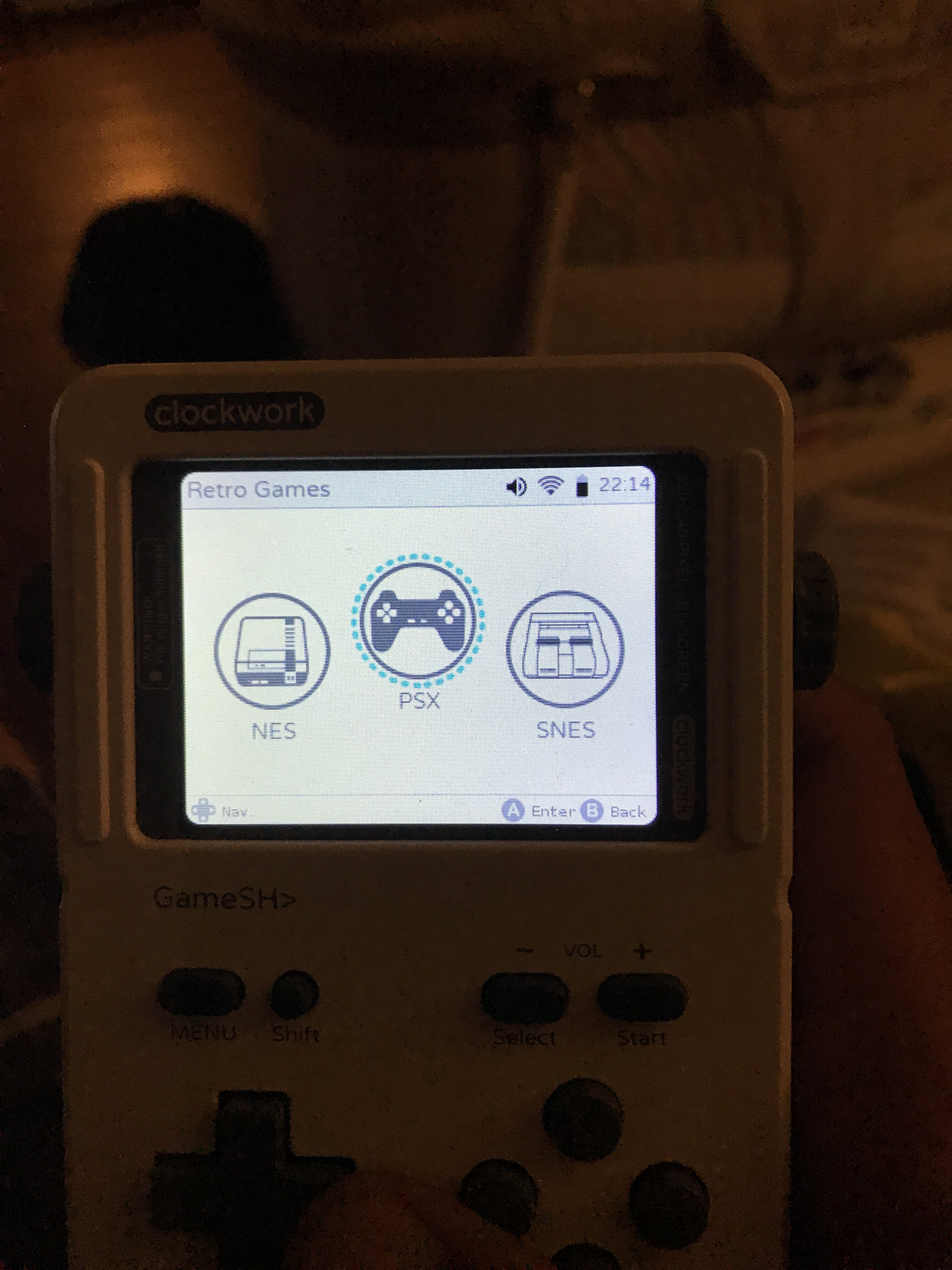

Anyone know how to rename is from pcsx to PSX without wrecking the way it runs lol
lol do uppercase count?
mv pcsx PSX
or from something like winSCP right click and rename
