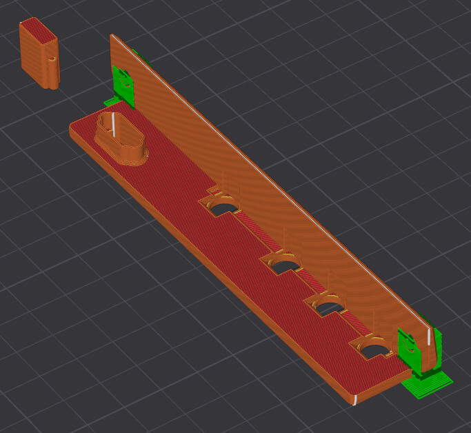

Has anyone already thought about designing a 3D-printable protective cover for it?
I think its this one, still WIP but hopefully we can get it. Reddit - The heart of the internet
update: someone got the design for it. Still haven’t gotten my kit so I can’t really tell about the fit though

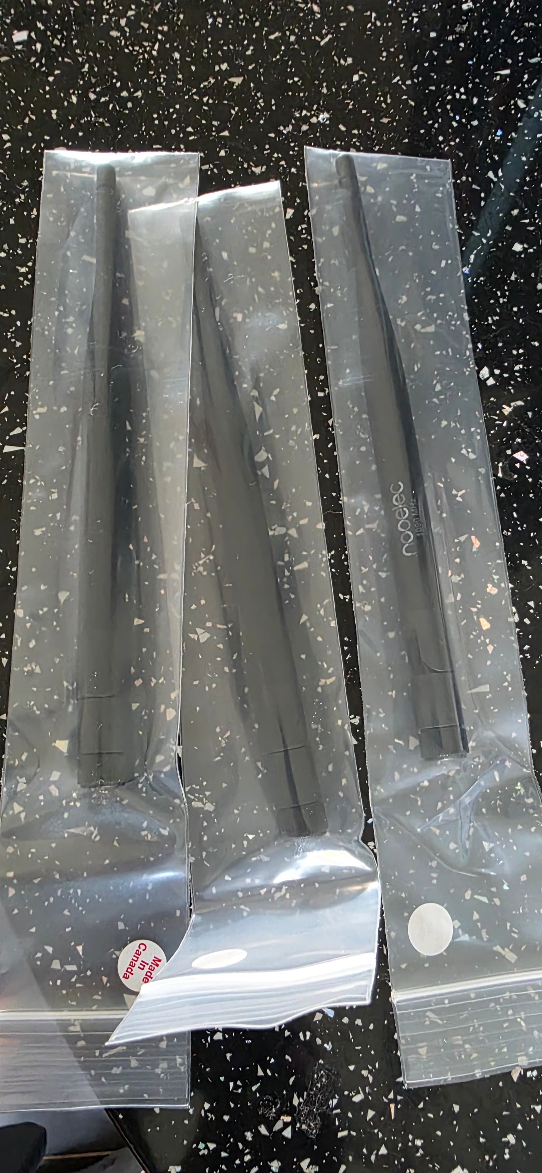

Just got my antenna specially for dump1090
I use the same one. Works great! :+1:t2:
