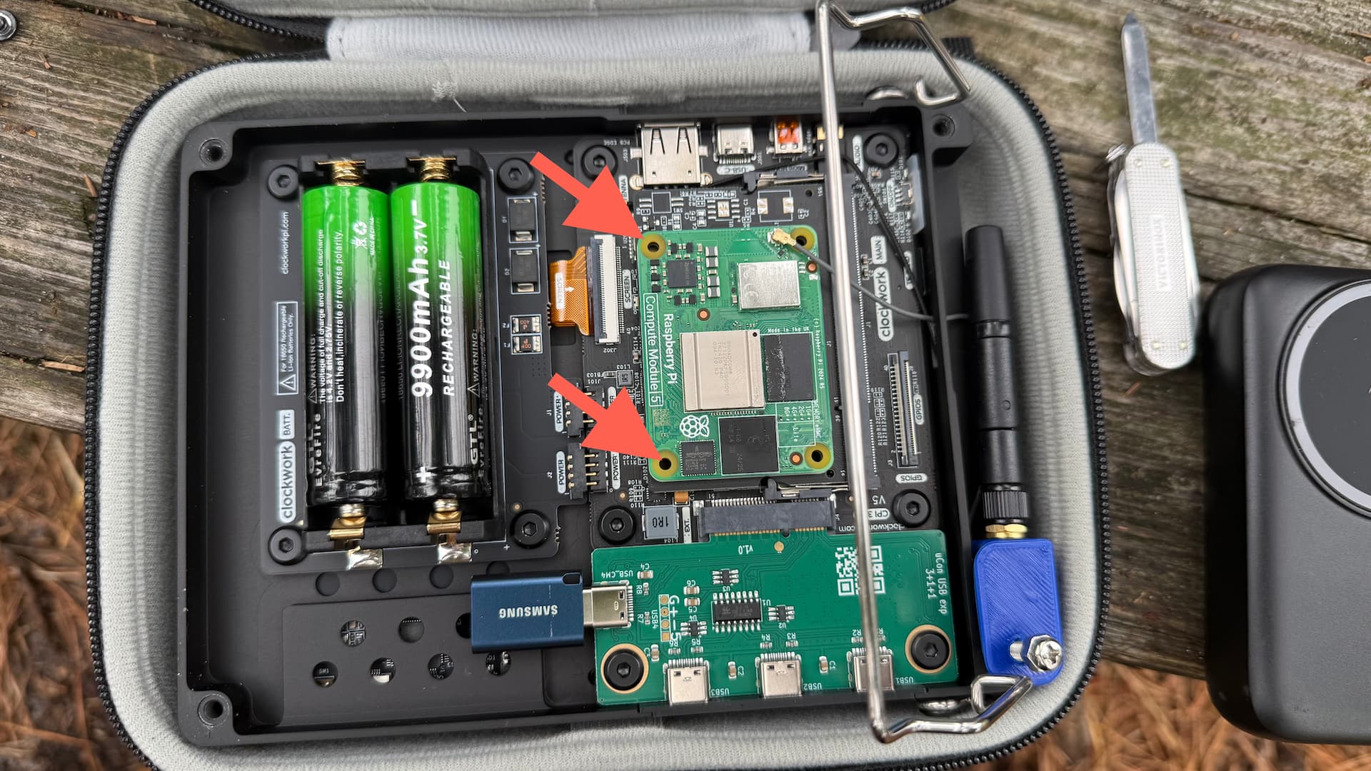

Is there a recommend size of screw I can use to secure the compute module board to the uconsole board? It popped out the other day and I want to prevent that from happening again.

well, I took it camping to ascertain it’s fitness as a telescope computer (software to control a camera) and to access some software I need while out and about.
Currently I have a CM5 on the adaptor board that came with the uConsole. I am still using the foam temperature pad and I am also just as astonished that the module managed to come un-done.
On the other hand, I’m dealing with Boy Scouts so I have no idea what was thrown on top of my bag or how many times (thus the need for a shack down of hardware before relying on it).

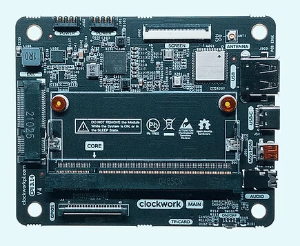

well, to be clear, I’m not talking about the adaptor board that the Pi Compute Module attaches to. That as we know has clips like what holds ram in place. I’m talking about the CM board and the adaptor board, both have holes that align but no screws.
oh you mean these ones with the orange tapes? yeah. its more of a spacer. also dont remove the tape, its an insulator.
so no screws fit that then?
yes.
[put 20 characters here]
The first thing that came to my mind: Some very tiny tie wraps could maybe work? :stuck_out_tongue_winking_eye:
Not sure, because i really dont feel inclined to open mine up, since its finally solid and working now. :wink:
But might be enough to keep the CM and Adapter board together.
And yes, group of kids explains everything, hahahaha
Those inserts fit the A06 module, not the CM adapter board. There is no way to mechanically secure the CM adapter board.
