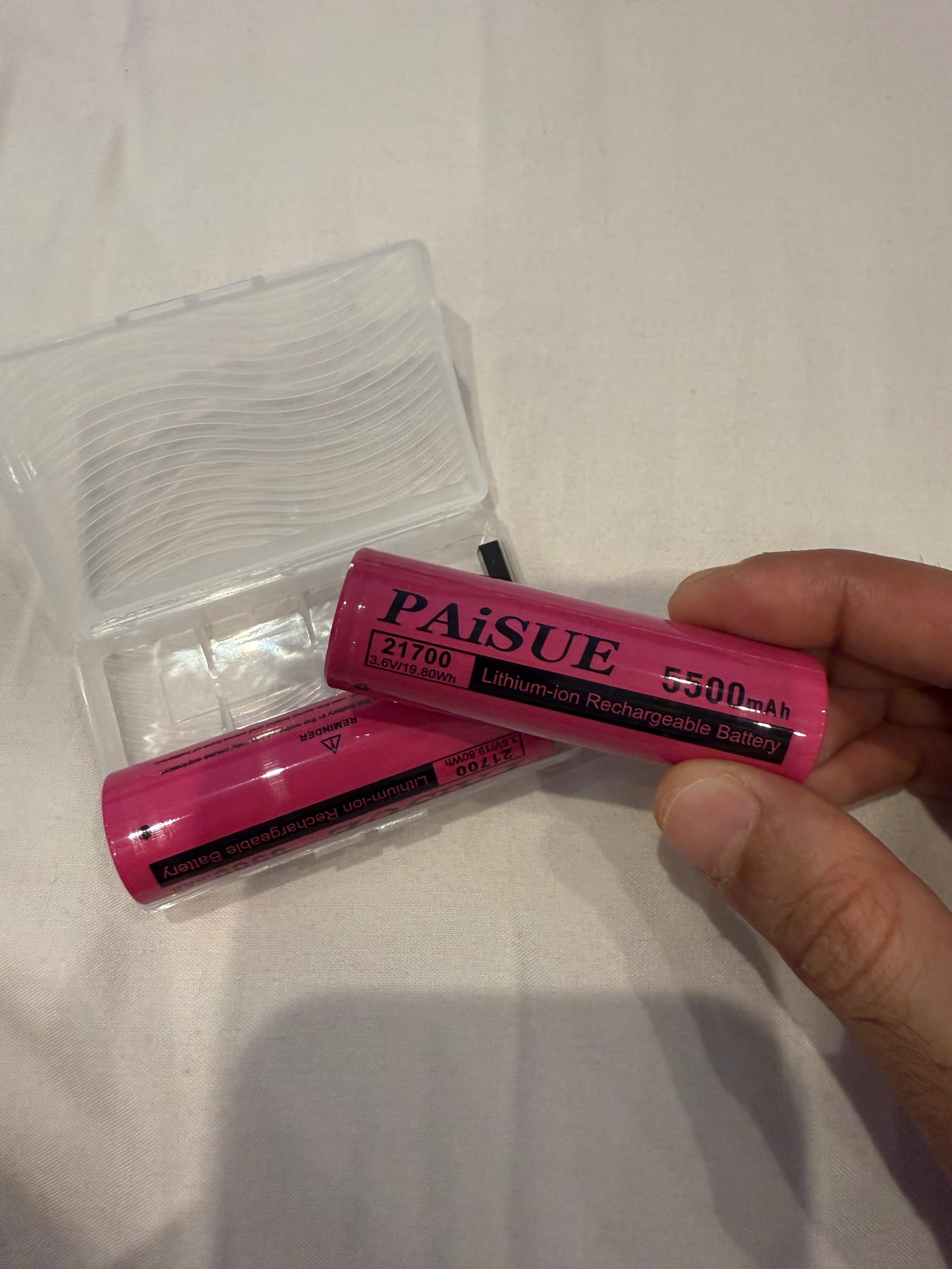

I just ordered my UConsole with WiFi and 4G, CM5 with 16GB RAM 64GB eMMC and a few PAiSUE 5500mAH batteries with charger.

wait, I just want to verify those PAiSUE 5500mAH you said. are they 18650s? if they’re a size larger it would not fit. Dunno if the clearance is good if you swap out the battery holder though.

Oh my days you are totally right.
They are not 18650.
All I did was search 18650 battery on Amazon and picked the one with the biggest mAH.
I should’ve read more thoroughly.
I’ll order 18650 right now.
Thanks.
from what i’ve seen, Nitecore and Xtar have the highest capacity at 4000mAH with the best reviews. nitecore is heck alot expensive though. good luck!
