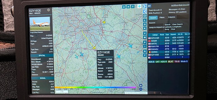

Calling all Tar1090 fans see Uconsole guide how to get Tar1090 workig on uconsole. Follow the guide below. Powered by Dragon OS thanks to @Rex
STEP1
tar1090 install
sudo bash -c “$(wget -nv -O - https://github.com/wiedehopf/tar1090/raw/master/install.sh )”
Click the following URL and replace the IP address with address of your Raspberry Pi:
http://192.168.x.yy/tar1090
STEP2
Automatic installation for readsb
sudo bash -c “$(wget -O - https://github.com/wiedehopf/adsb-scripts/raw/master/readsb-install.sh )”
sudo reboot
Update
Handy commands for readsd.
Run until next reboot
sudo systemctl start readsb
disable service
sudo systemctl disable --now readsb
Enable on every boot
sudo systemctl enable --now readsb
To uninstall readsb run:
sudo /usr/local/share/tar1090/uninstall.sh
Tar1090 GitHub - wiedehopf/tar1090: Provides an improved webinterface for use with ADS-B decoders readsb / dump1090-fa
Readsb Automatic installation for readsb · wiedehopf/adsb-scripts Wiki · GitHub
Well i will attempt to get this working using the sdr lora expanshion card to decode signal.

Dump1090 guide above tested and working with the SDR LoRa expanshion module. If you try to run without the SDR device you will get the below.

New guide above updated using tar1090 and readsb. This conbination is a much better user expireance and works great on the Uconsole using the SDR LoRa expanshion board.
