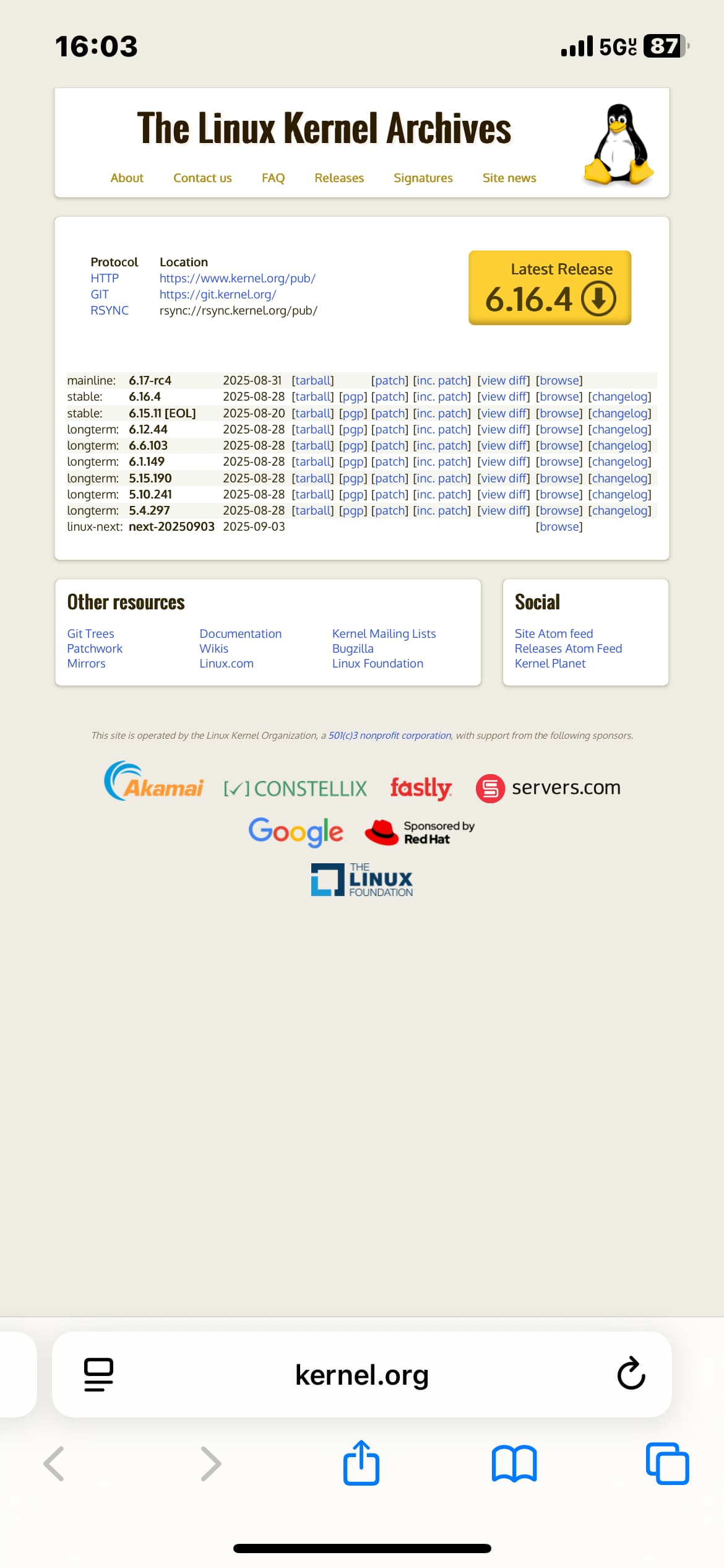

Yes 6.16.y is available but it’s not a LTS kernel. Support for 6.16 will end around the end of the year. 6.12.y is supported until 2036 and is the officially supported kernel for Debian 13.
