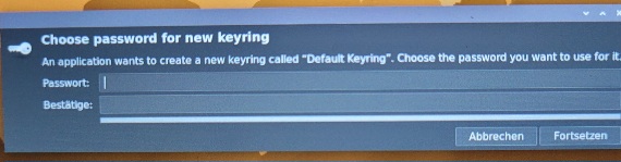

Why do I recently get the following message when I start the Chromium browser? ā€œBookworm and Trixie.ā€ And can I disable it?
it’s wanting to setup a keyring that manages and protects your passwords and cryptographic keys. you can just set it up without a password and it will leave you alone after that or setup a password and enter it when the keyring needs accessed.
I entered a PIN. But now the browser still asks for it every time I start it. This is new and hasn’t happened before. Can I disable the request?
yes every time it starts it will ask for it to decrypt the keyring. you need to not use a password then it won’t ask anymore. you can delete the existing keyring and set a new one up without a password.
If you don’t mind logging in to your uConsole using a password, you can do the following:
From Control Centre, setup your uConsole to ask for your password when logging in. Then go to Accessories → Passwords and Keys and create a new Password keyring called ā€œloginā€. Set the password for this keyring to be the same as your login password, and also set this keyring to be the default keyring.
If you do that, then the keyring will be unlocked automatically when you login, and apps that save credentials to the default keyring, such as Chromium, will be able to do so without requiring you to unlock the keyring. Note that the default keyring needs to be named ā€œloginā€ and also it needs to be unlocked using the same password that you use to login with your username.
