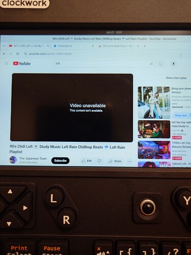

Encountered a strange issue: none of the YouTube videos can be opened. What could be the problem?
sorry about the issue,It’s the damn network issue.

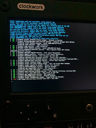

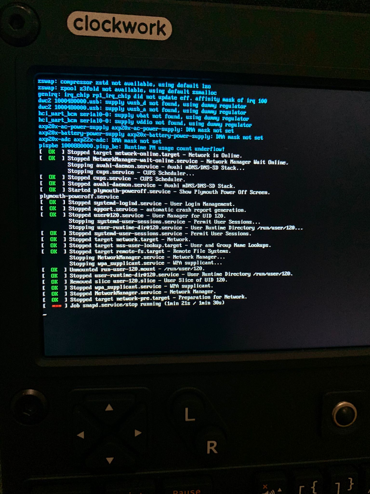

Its turning off immediately. Im using a CM5 16gb ram 64gb emmc. Can you please suggest me what to do now?
What context is it turning off immediately. Are you trying to boot it for the first time?
