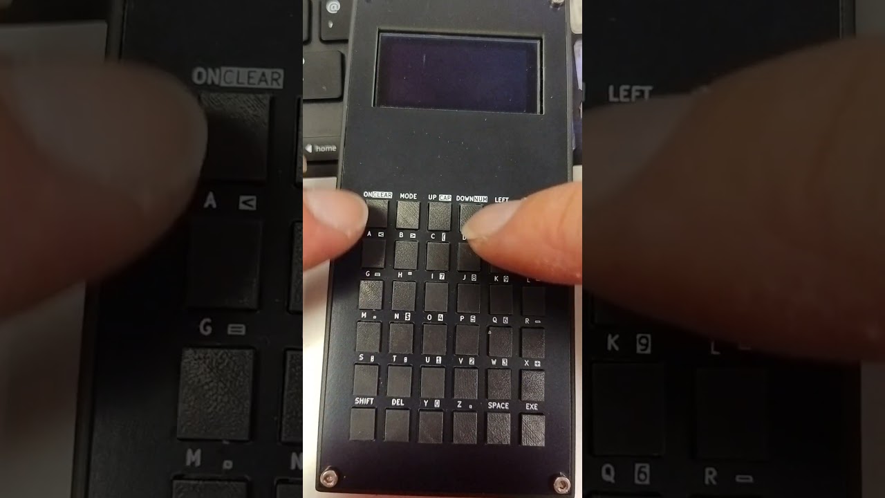

This shows it in use, for anyone who is interested:
