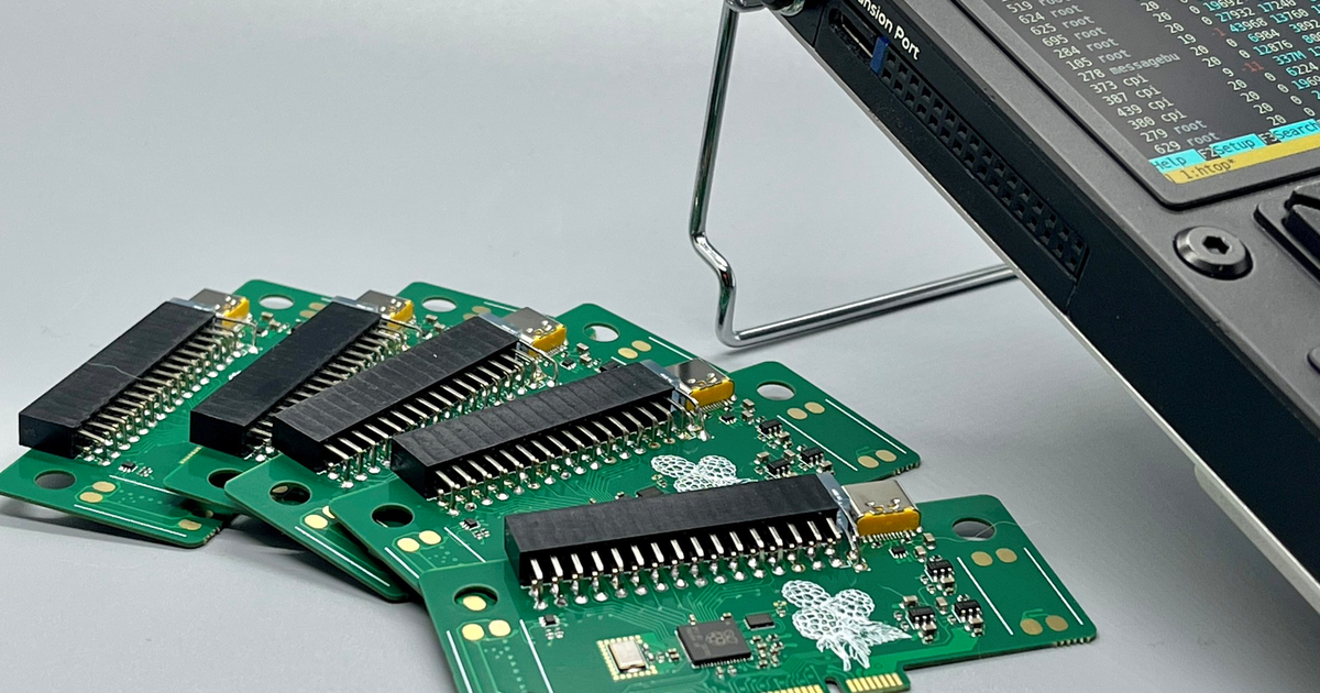

@Vitaly – I got my uHub board; the speakers work, but the ports do not. Any thoughts?
Sorry to hear that, let’s try to find a root cause.
Could you try lsusb and post program output?
Also it will be helpful to get a photo of uHub on chip side, maybe something go off during shipping.

I tried another peripheral with an indicator LED and verified that the ports do work; I think the original one I tried (Sandisk Extreme Portable SSD) just drew too much power. That’s on me for not doing my due diligence.

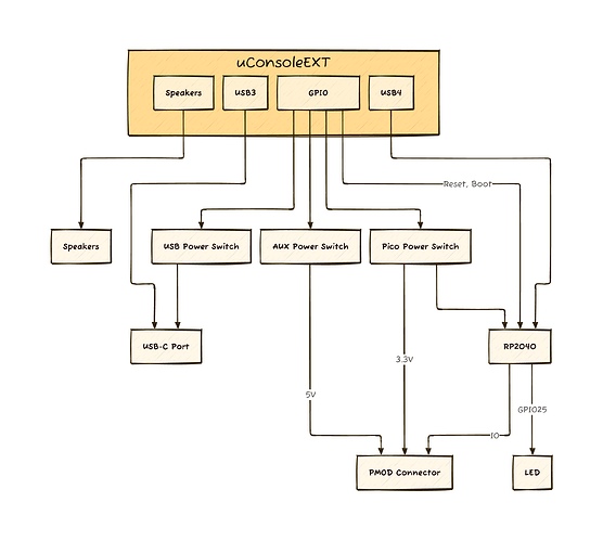

Yes, by default, current maximum is 500mA per port.
But you can easily update that by changing values of R9, R10, R13.
See schematics:
