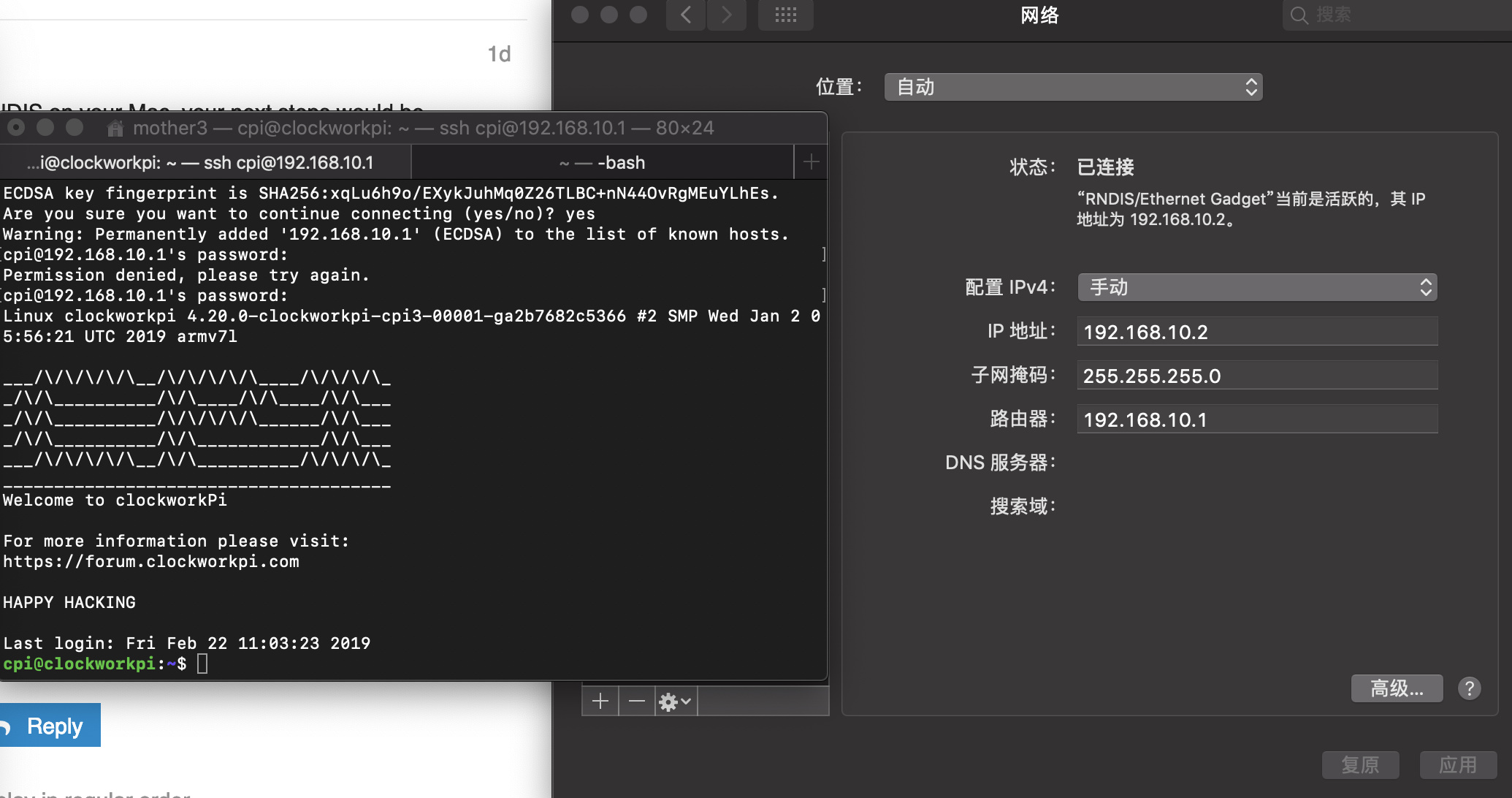

If you followed the above setup, and installed HoRNDIS on your Mac, your next steps would be accomplished in your System Preferences on your Mac. Go to the Sharing Preferences, and select Internet Sharing (Don’t turn it on yet!). Set Share your connection from to Wi-Fi or Ethernet, depending on which your computer is using for your network. Then check RNDIS/Ethernet Gadget in the lower box. Now turn it on with the checkmark and confirm by clicking the Start button.
Now go to the Network Preferences. Select the RNDIS settings. Configure IPv4 as Manually, IP Address: 192.168.2.10, Subnet Mask: 255.255.255.0, Router: 192.168.2.1 and then click Apply.
Now when you connect your GameShell to your Mac, it will have full access to the Internet through your computer. You should be able to SSH to your GameShell with the command:
ssh cpi@192.168.2.2

If you setup Internet Sharing to the RNDIS then your GameShell has access to the Internet. To transfer files, all you need to do is select clockworkpi in the Shared list in Finder. It will request User Name & Password; Enter cpi for both. This will give you access to both the games and music folders.
每一步我都确实按照您说的操作,但是finder里面却看不到clockworkpi。。。我之前也疑惑了很久。。。
